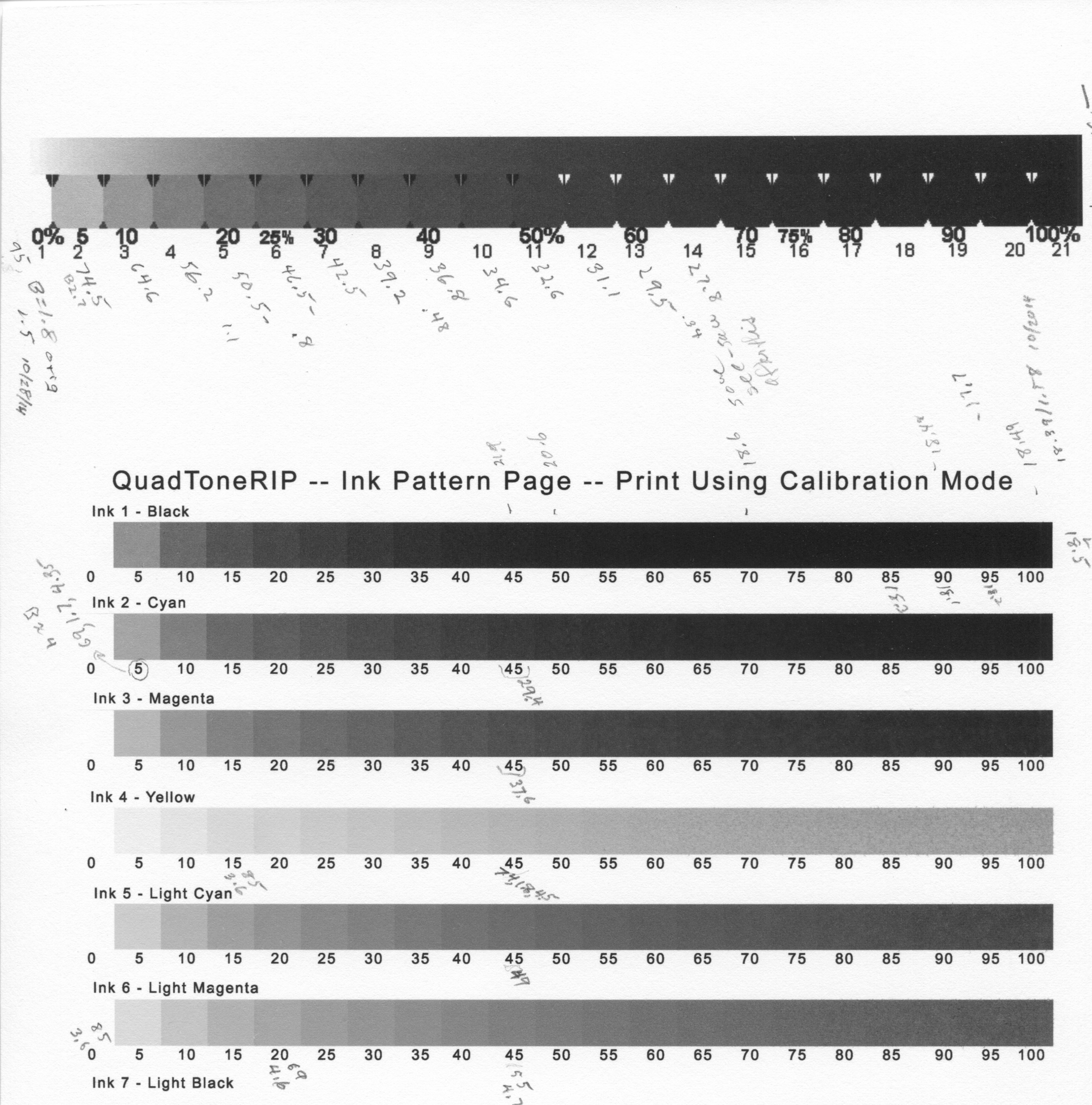

A scan (360 ppi) of a Calibration Mode QTR print on Arches is posted here:
All sharpening was turned off, exposure was on auto, and no modifications were made in Photoshop.
This "eb6" was mixed by me from STS WJ1082, which STS claims is the same as it was when Image Specialists was supplying the input MK for Eboni inks. I mixed the "eb6" dilutions with my C6c generic base.
Note that the dmax on the Calibration Mode print was 1.58. When printed vertically on Arches, it jumped to 1.68. With 2 positions of black, it jumps to 1.75.
I have no idea what MIS's current Eboni products are composed of. I know they were testing the new STS inputs. The reason I bought the STS wj1082 was that my last batch of MIS Eboni did not print the way the older Eboni-6 used to print a year ago. I have no idea why. I have now purchased two different lot numbers of STS wj1082, and they are essentially identical. So, what evidence I have suggests that STS is very capable of producing consistent inks.
