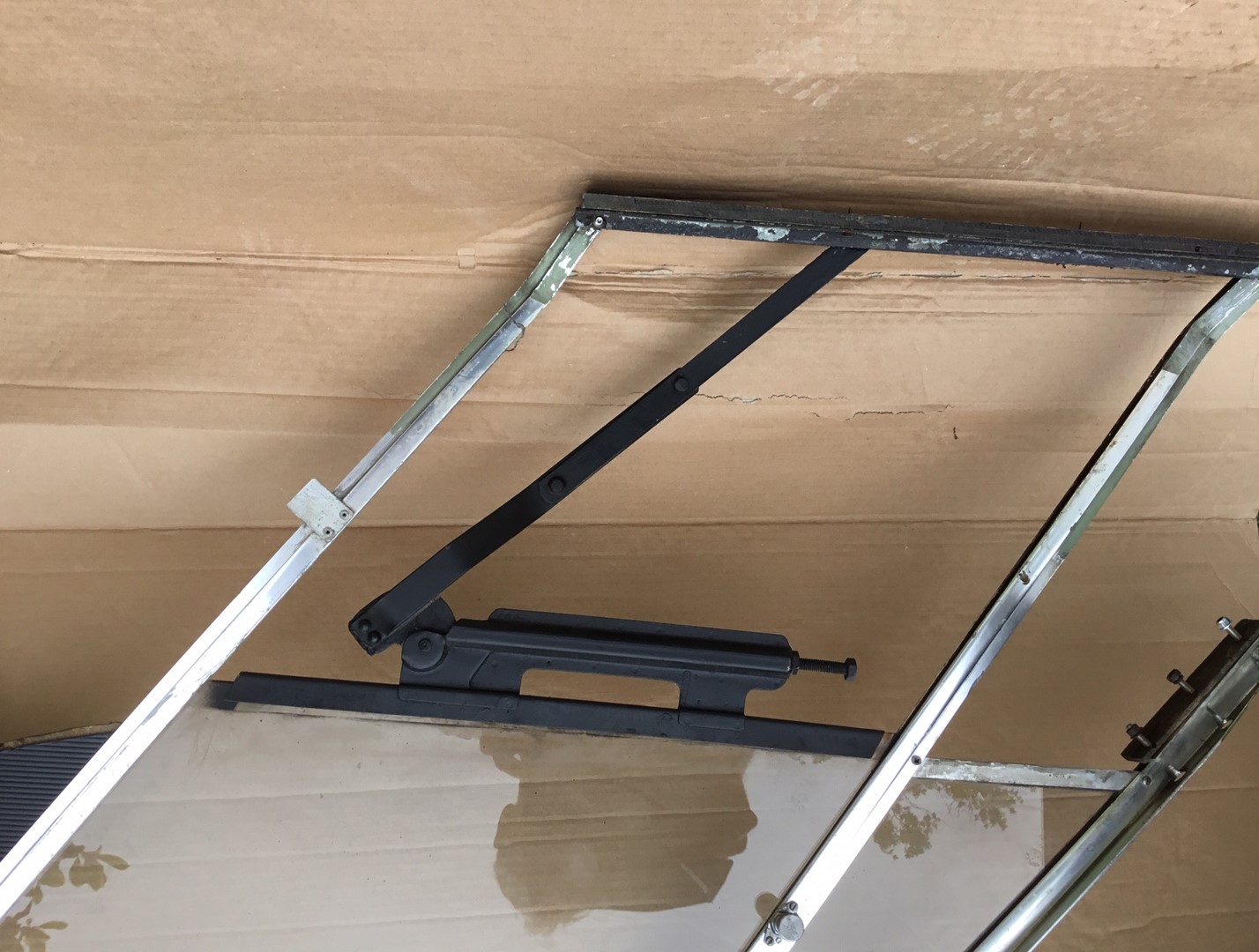

I will take more pictures and measurements for you today, it works on a very basic system of a
spring loaded section which can be adjusted by the bolt as seen in the picture this stops the
glass from dropping or pushing glass up by creating neutral balance of weight allowing you to just
push the glass up or down by hand the pressure is transferred down the pivoted flat steel bar
that runs freely in the horizontal channel at the bottom.
Rob

I have never seen one of these and would like to try to fabricate one for Greg.
Would it be possible to take pictures with the window at different levels? I need to know how it lifts and lowers; what parts move and in which direction.

Thank, Bob,
That would be most helpful.
It would seem that the unit was mass produced at some time, but I have no description of what it was ever used on other than the Marcos.
