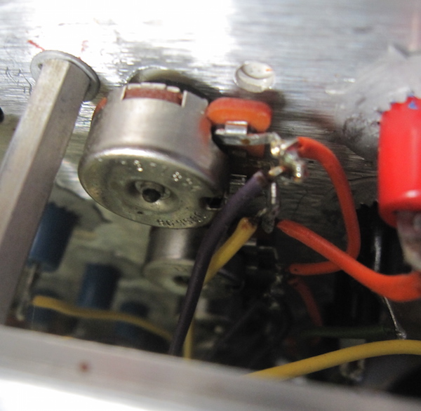

This is what is written on a couple of them:
1377545 / YF6781
1377834 / DB5696
Looks like these are CTS pots, if I do not mistake.

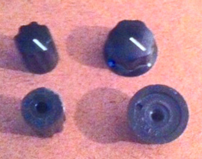

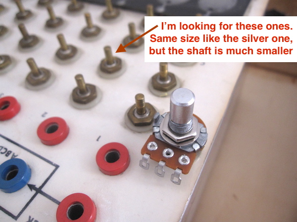

I'd love to find the same orginal ones (hem hem), but if not possible, I need to find the same kind. The shaft is very thin. They go with the orginal Davies knobs mounted on the original serge, with very small holes.
Taken a few mins ago. Yes, it's possible to take such shitty pictures in 2016!!!
If you have an idea where I could get these or ask, I'll start checking which values exactly I need for all the panels (I guess there are not all 100k as the ref numbers change).

Thank you. I checked the 3 pages of pots from the link you sent and did not see any with the kind of mini shaft that I'm looking for.
Did you see the picture I posted?
Not sure which one you mean?

CTS 270T series are the current version. Available with 1/8" (3.19mm) shaft.
http://www.digikey.com/catalog/en/partgroup/270-series/5630
