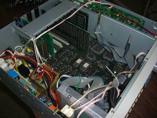

Thanks can you tell me if this S1100 has memory cards from pic
I want to buy at auction

right beneath the longest board in the case, there are 2 memory cards installed.
You can install 4.
It\ufffds impossible to recognize if these are 2meg or 8meg cards.
With 2x2meg cards,- the display reads "2 megawords" (=4MB) when powering up,- w/ 2x8meg cards it reads "8 megawords" (=16MB)
2 and 8 meg cards = 5 megawords (=10MB)
Ask the owner how much it reads when powered up and before you buy.
