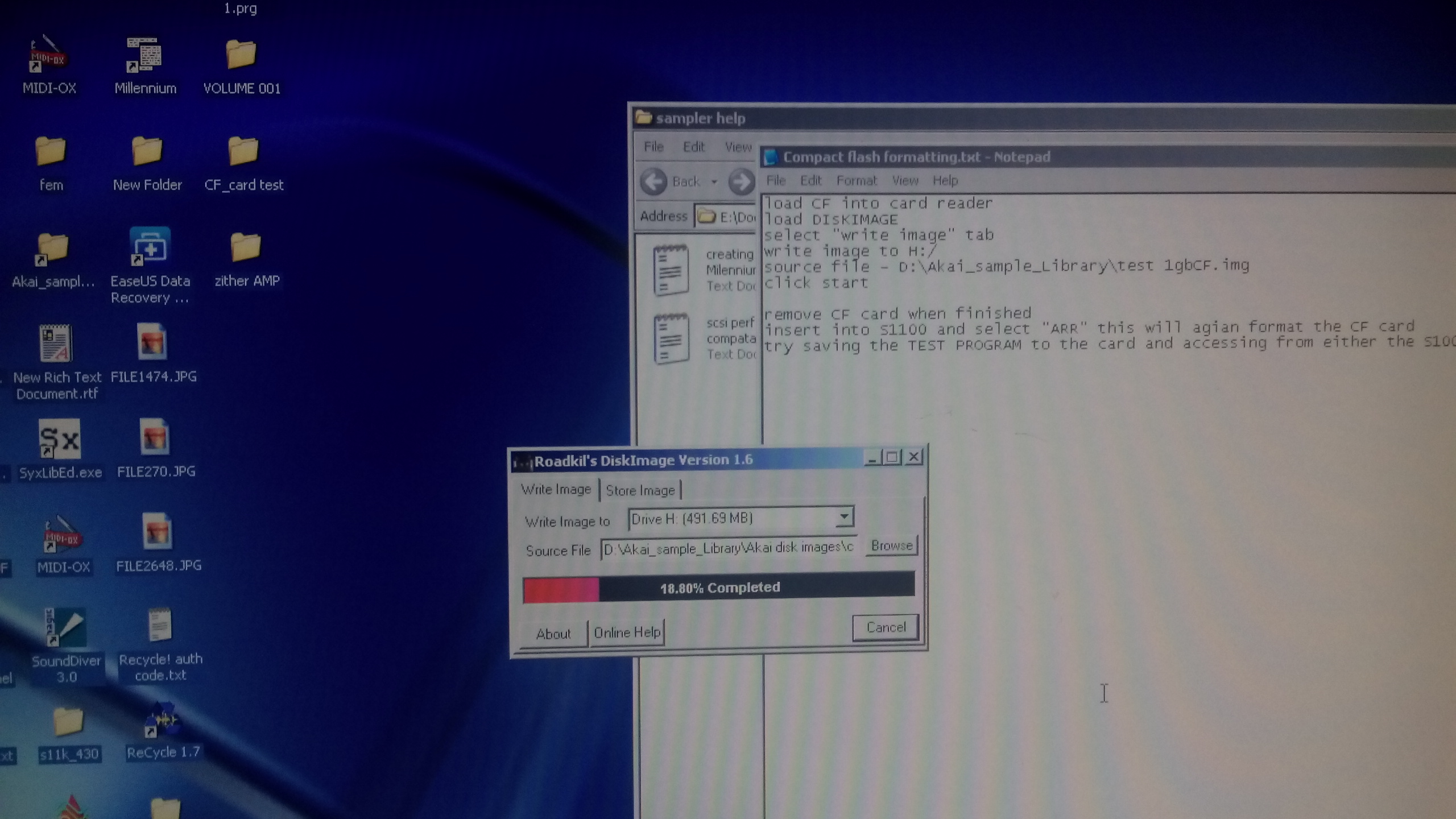

I've just checked my setup and its Roadkil's Diskimage v1.6
See pic for details and a little text file I had made to remind me how to do the process
Hope this helps

Re: Easiest card reader solution?
2016-06-15 by djrectape@...
I was to quick to tell everything's ok.
In fact some samples play great and some are still glitchy...
I changed the scsi internal so this one have only two connectors.
Do you know if the problem is related to the raizin monster or this would be the same with other card readers?
I'm not sure to understand properly your last step with the roadkill's method :
After the re-arrange I copy the test program to the card and reload it from the card. Do I need to use the wipe function?
Is this last step vital or just to see if it's work? because I can hear the test program with no problem but when I add programs from Chicken translator or the fdd, they're not fully functional.
I'm trying right now with an other card. Finger crossed.

Hi there, sorry for the late reply…
My test was to wipe the default samples from the sampler memory and then load them back in from the CF card to see if there was any corruption..
If I remember correctly, The reason I came up with the convoluted way of formatting with Roadkill, was because I had 4 CF cards and I could only get one to work by formatting with the S1100 'ARR' function.
So I took the working card and copied the drive image to the pc via a usb card reader and Roadkill.
I then put in the non working CF cards into the USB card reader and transferred the image of the working CF card to each of the non-working cards from Roadkill…
I then put each one in turn into the S1100 and hit 'ARR' and the formatting worked every time on all 3 other cards.
to test each one I just copied the default program and samples to the Cards, wiped the samplers memory and loaded them back to test.
Interestingly, the original CF card failed about a week later (this was the only card that roadkill didn't 'format' first) as I was unable to save samples to it any more.
So I copied the process which I had used for the 3 other cards detailed above, and since then I haven had an issue on any of the 4 cards.
It appears -i don't know why - that roadkill, whatever it does seems to stabilise (for want of a better word) the cards before you arrange them in the sampler!
Anyway, now you have a working card, why not create an image of it using roadkill and restore that image to the knackered card, and arrange it again in the S1100 -like I did, and who knows, it may start working for you properly :)
Good luck
