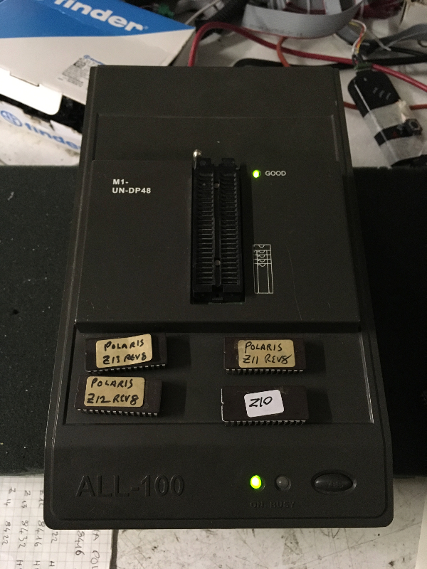

Dear Paul ,                 programming new Firmware Rev 9 and rev 11 , it doesn't work for my Polaris.It is possible to have the Checksum ?Must I recheck all the power supply Voltage before reinstalling the new Eprom ?Should it be RAM Problem after " mamma mia "  30 Years ??
Best Regards .
Ciao
P.S. I use the M1 - UN DP48 programmer .As shown in the Photo Below .

RAM is quite reliable. However, different software versions locate things in different places in the RAM, so upgrading requires that you redo all the calibrations and reload your data. If the panel switches work but you're getting no sound, that is likely the problem. If the switches don't respond, then you could perhaps have mislabeled the EPROMs and inserted them in the wrong order. If it worked before the change, then it should work after the change.

The most common problem I used to see was customers not having the configuration correct for the 2764 vs. 27128 ROMs when Fender was sending the software updates for free… Two vs. 4 EPROMs. It’s in the service manual, but...

I think he's referring to jumper settings. But if you erase and reprogram the old EPROMs, that won't be an issue.
