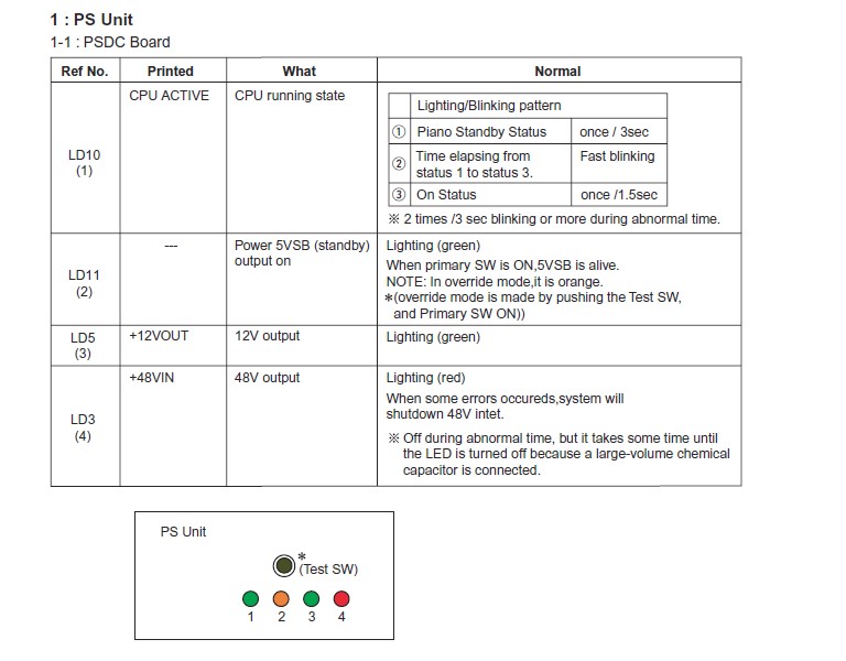

I have a C3DKV Mark IV which is 6 years old and has given up the ghost. I turned it on and a fairly loud bang came out of the speakers and none of the lights on the control panel illuminate. The only lights underneath are a solid green light on the power supply and a blinking green light (2 second intervals) next to the solid light. Looks like a power supply failure.
Any suggestions.

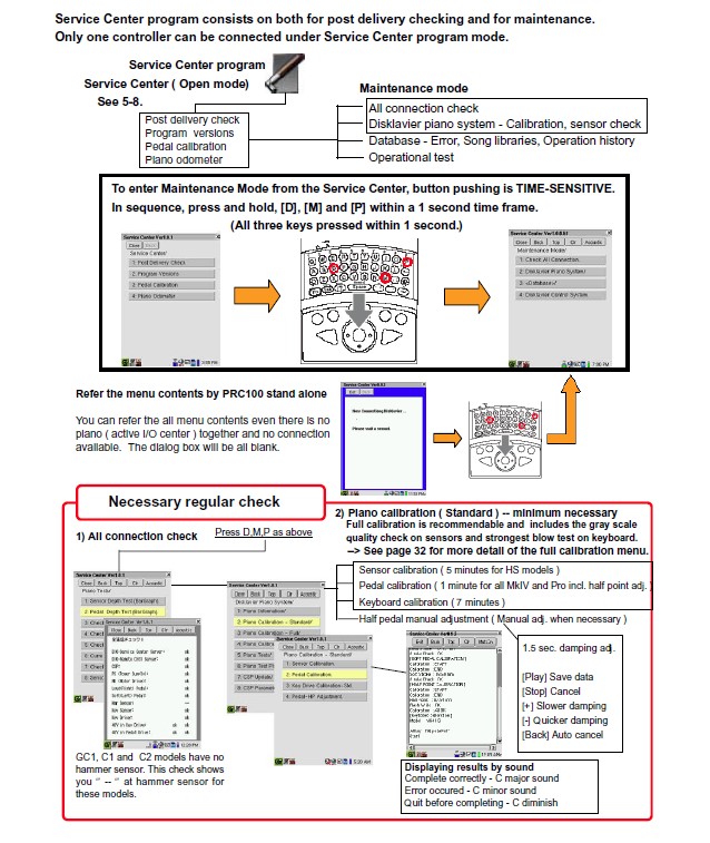

The blinking LED in normal Power supply is as shown in the attached figure.
I guess you can get error log and so try to  enter the service center mode from the controller and trace Service centre--Data base--Log view--All error--Order by date and look at the error log.
