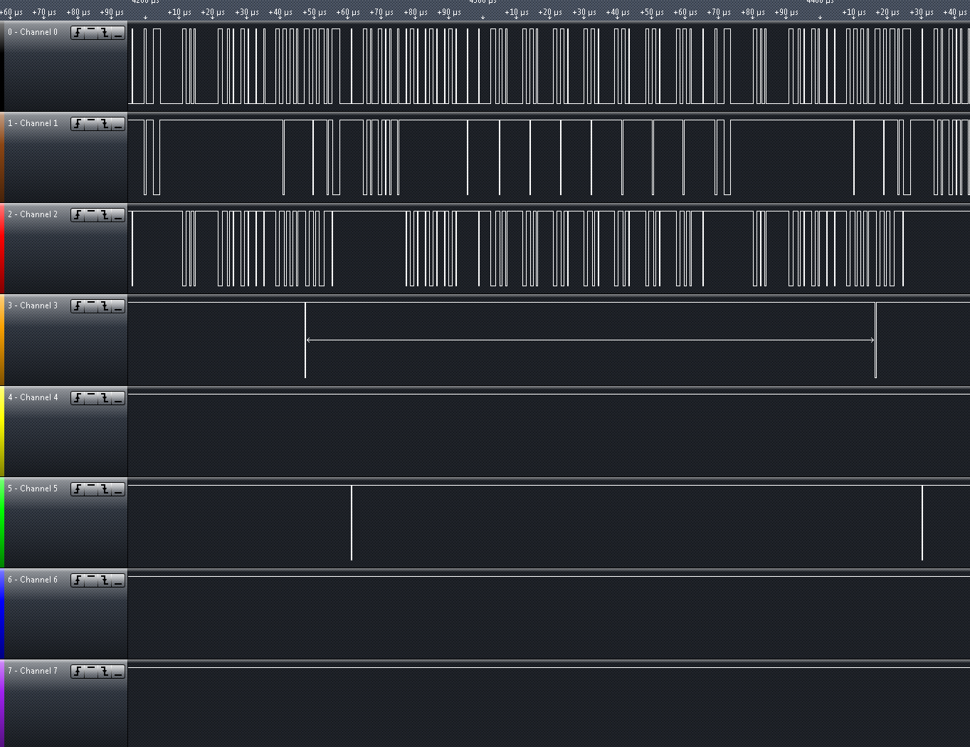

2015-11-28 by mmdatech@...
Hi Mike,
I have attached a screenshot from my logic analyzer showing the IC29 outputs
( channel 0 = Y0 , channel 1 = Y1 and so on ).
There are little or no signals on Y3 to Y7 so it must be the memory check .
Does that mean the problem lies with the 8155 or the 6116 ?
your help is greatly appreciated :)
Re: [korgpolyex] another dead 800 [1 Attachment]
2015-11-30 by Michael Hawkins
check the reset circuit.
check power supply is stable and on voltage. +5V needs to be within TTL tolerance levels which is about 10% so even a crappy multi-meter should read close enough to be within 10%.
check that the write, read and chip select signals are reaching the RAM 6116.
check all of the data and address lines are at the RAM.
How did you assemble the 80C85 code? Other than me and one other person, no one on this yahoo group has ever created a working piece of 80C85 code.
sometimes chips fail, but rarely. let's keep assuming that it isn't the RAM itself, not just yet.
/Mike
