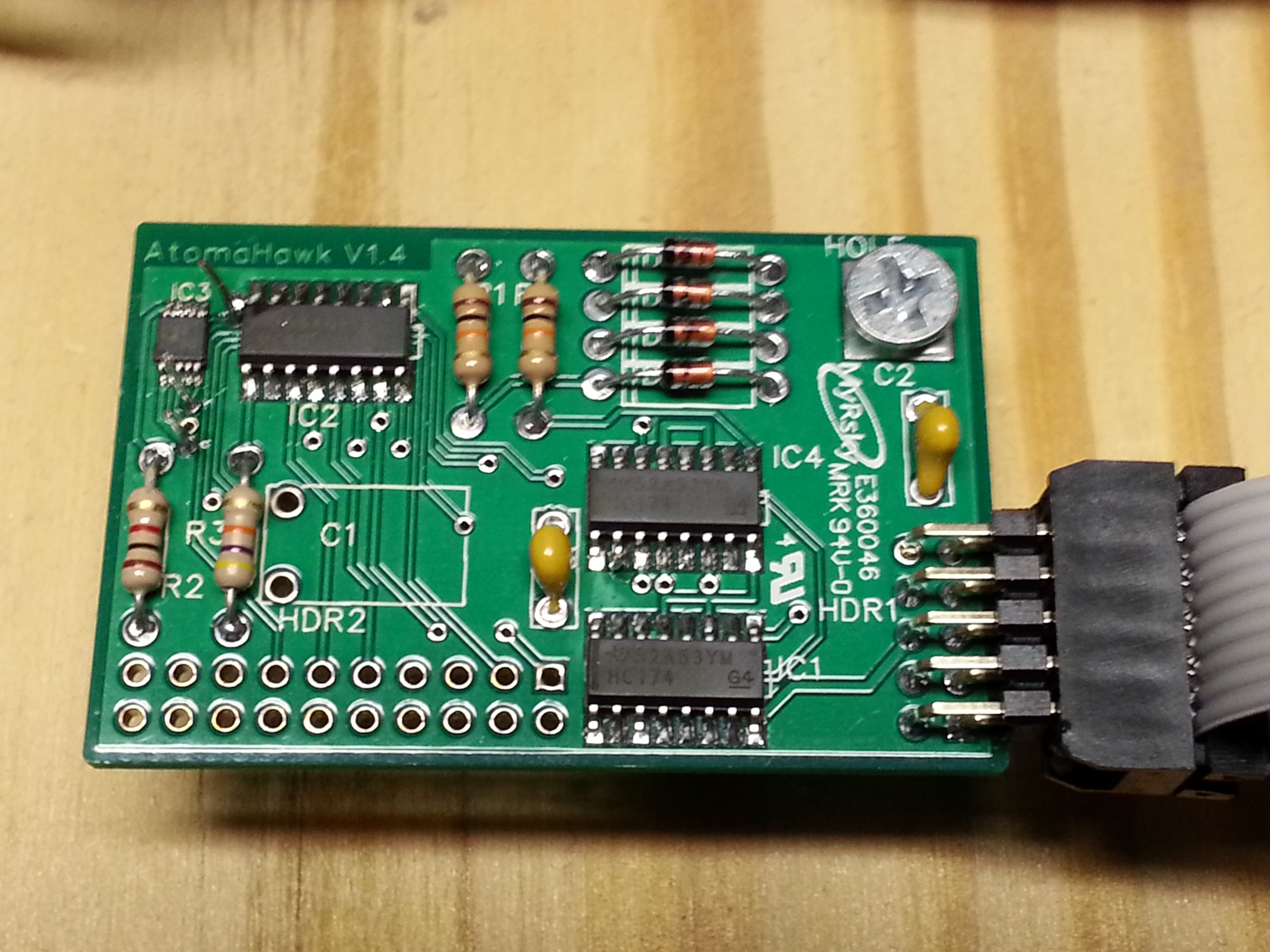

AtomaHawk - new hardware version in final testing
2016-06-05 by Michael Hawkins
The original AtomaHawk board used a Maxim DS1666+ 10K quasi audio taper digital potentiometer chip that Maxim stopped making and then the after market source dried up and they got way too expensive.
So, I went looking for a new through hole chip that could be used but alas I was completely unable to find one. What I did find was a far better device but it is only available in surface mount. I finally had to go through the process of figuring out how hard (or not) it is to create surface mount boards in small quantities.
The AtomaHawk version 1.4 is now in final testing. Here's a photo of the first board made.
Major improvement here is that the original DS1666 was only capable of handling 7 bits and also used a non linear range. The new device is 8 bits - the Analog Devices AS5290. Datasheet is attached for anyone that's interested.
I expect to be shipping the new version out in a few weeks.
/Mike

Re: [korgpolyex] AtomaHawk - new hardware version in final testing
2016-06-06 by Michael Hawkins
Ha ha! Yes, I was very pleasantly surprised at how easy it is. I am actually kicking myself for not having tried surface mount ten years ago. Stupid really. But I guess you get used to what you're doing and sometimes you don't want to change what works.
But in this case, going to surface mount has some challenges but they can all be overcome. As long as the board isn't too big or uses the really small SMD components.
The AD5290 is a TSSOp which is very small to handle with tweezers. It can be positioned but it is really difficult. So I am making a jig that will help me to place it. I shall let you know how that goes.
But as always Gordon, your questions are always a strong indication of your insight. So why the heck didn't you tell me to try SMD earlier? Eh?
/Mike
Thanks Wayne, coincidentally, I ordered a couple of those last night. I use a fixture jig for placing the board and orienting it to a kaptan stencil overlaid for applying the solder paste. I then use tweezers which is by far the hardest part (especially with the tiny AD5290). I then place on a hot plate, using a laser temperature sensor and visually watching for the solder to run. I take the board off using tweezers, I found that applying the solder paste in the right quantities and consistently across all solder pads is tricky. But that is something that gets better with practice. And most importantly, if it isn't perfect, wipe off the paste, clean the board and stencil, and do it over until you get it perfect.
And then the really hard part is placing really small SMD footprints such as MSOP. Tweezers make the job quite awkward and I realized that is because they don't help you to line up the device radially/rotational at all and they also amplify your hand natural shaking movements. So a suction tool and a arm/wrist bench/rest are critically important.
It's been a lot of fun going through the learning experience and it has now completely revolutionized my view of designing and building surface mounted designs. Especially with the STM32 upgrade in mind.
/Mike
2016-06-08 by Michael Hawkins
No, I don't use a reflector. The conduction from the hot plate to the board seems to me to be dramatically more than anything a reflector might do. Still, maybe I should look into and do some testing./Mike

Well, I've been learning how to populate SMD's on the new AtomaHawk. And I'll be shipping out the first batch to customers very soon.
Other than that, not a lot going on right now because of 'real' work. One has to provide for the family.
But I did buy a bunch of STM32 development boards.
