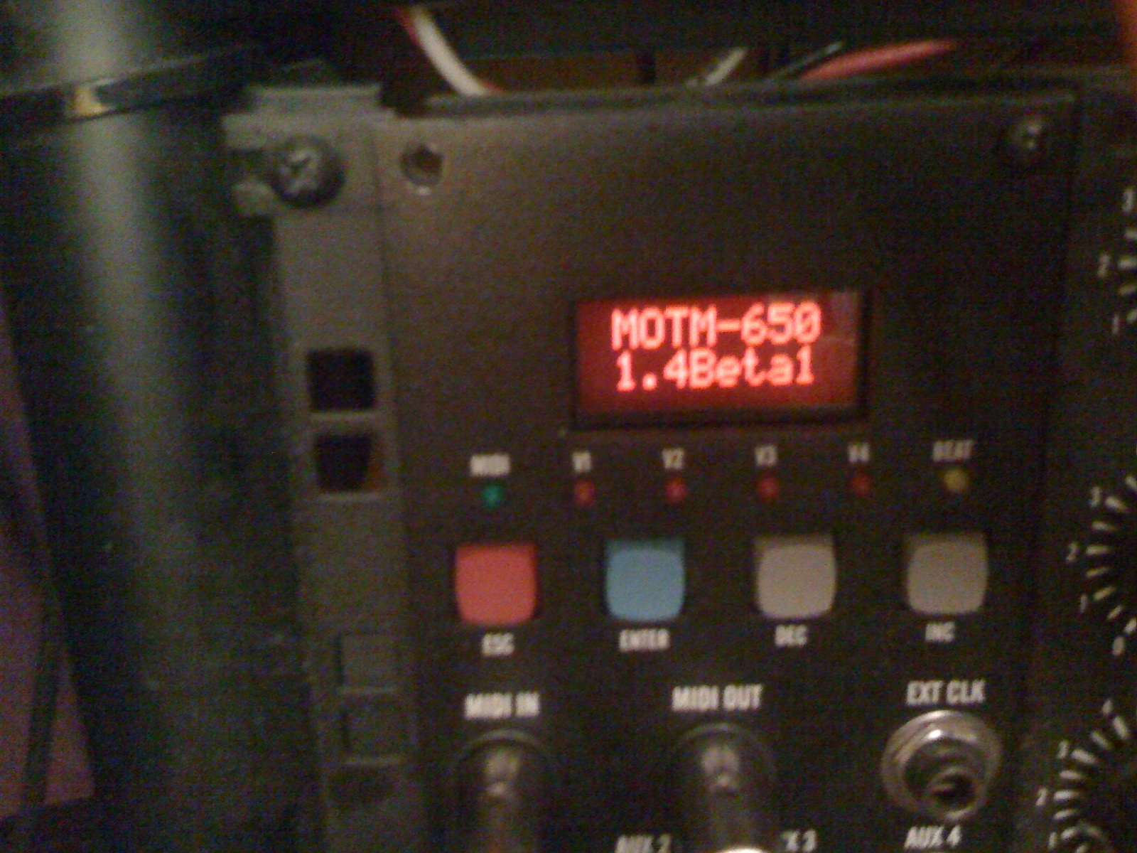

2011-10-11 by J.D. McEachin
If you'd like to beta test the new firmware version, or just follow
the testing progress, send a message with "SUBSCRIBE" in the message
body to motm650-request@....
Note that there is currently no OS-X version of the firmware
updater.  I don't like it, but that's how it is for the foreseeable
future.  :(  There ARE alternatives.  An OS 9 version is
available.  Source code is available.  Many Mac people run Windows
under Boot Camp, Parallels, or VMWare Fusion (even my decidedly
non-techy wife).  Some run Windows apps using WineBottler (
http://winebottler.kronenberg.org/ ).  It'd be great if someone would
try the SFUU program under WineBottler to see if that's a possible
free solution.
I'm hoping to have V1.4Beta1 out this week.
Jeffrey
