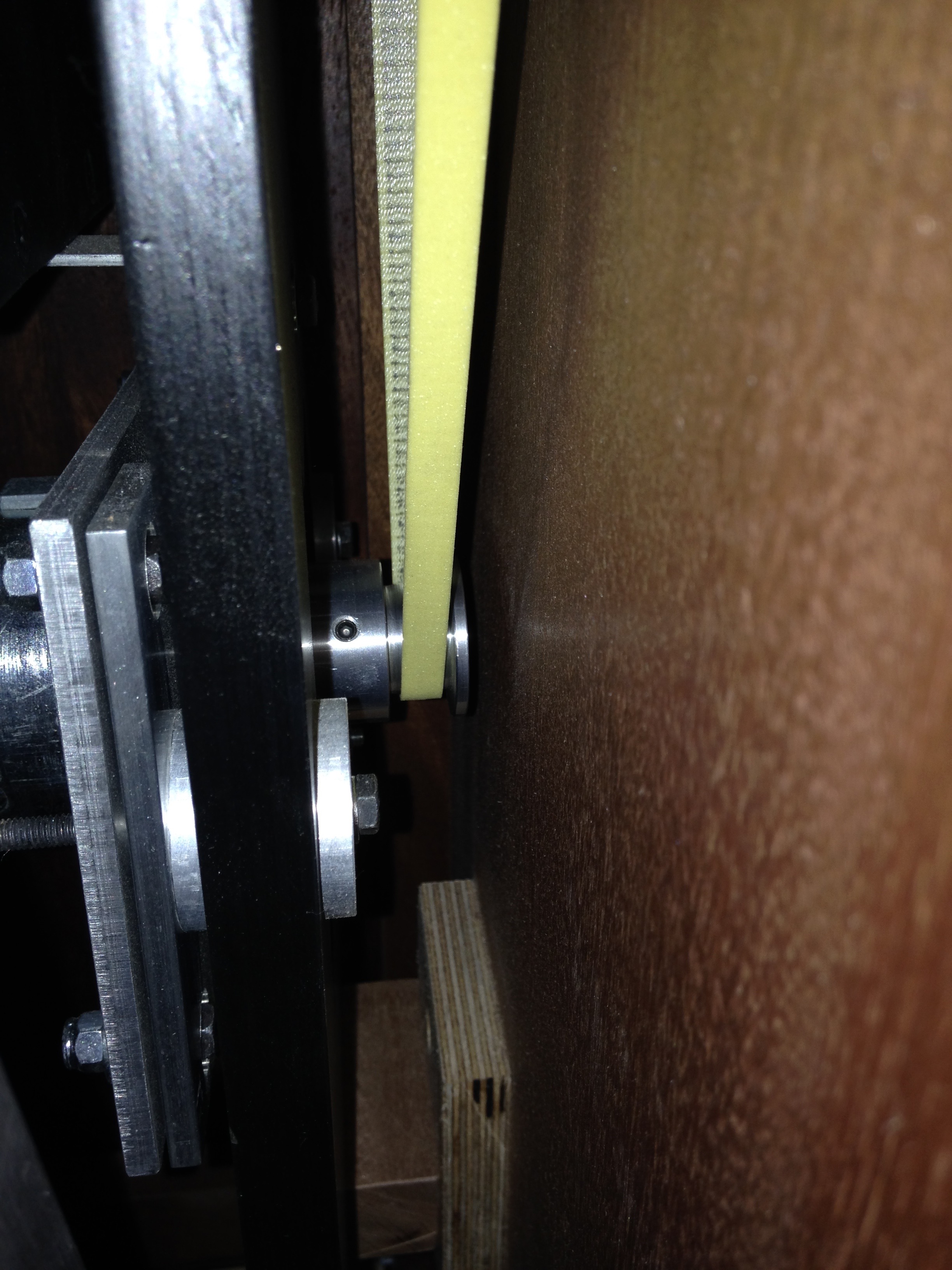

Frank,just an idea, is it maybe possible to have these belts in a slightly bigger size so that it will slip by itself? Or do they come in standard size?
I've taken a look at the capstan (which I assume is the smaller rotating cylinder below, pls see picture). Do I loosen it by adjusting the screws in the holes (as seen in the picture) of this cylinder?
Raymond
