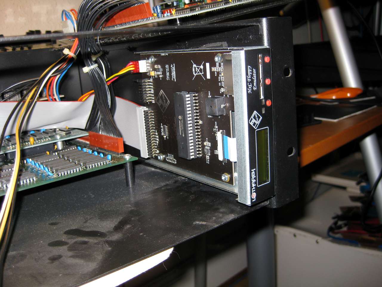

2015-04-02 by Peter Mörck
A bit expensive, but I didn't want to bother with disks.
Each disk is stored as a file on the memory card and you choose a disk-file on the emulator and the Prophet will see it as if you changed disk.
Of course, if you have disks you need to read them on a computer and store them to the SD Card before you can use them in the Floppy emulator.
I never use the Prophet at all actually, but I'll keep it anyway, for that time when I'll feel like using it ;)

Re: [prophet2000] Re: Restore prophet2000 Belgium
2015-04-02 by jhn_llwllyn@...
There are cheaper (chinese) alternatives for Floppy Disk Drive replacement via USB stick:
Does anyone have any experience of these ?
