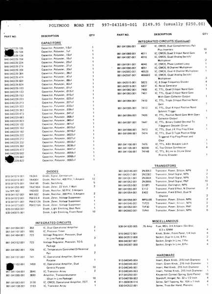

polymoog maintenance kit
2009-06-23 by Terje Winther
Years ago, there used to be a "polymoog maintenance kit".
Does anybody know what this contained?
I guess it is impossible to get one of these now.
Please don´t repeat all that has been said about the polymoog and it´s need for service (I have read the archives) - but could someone please direct me to a site and/or discussion group with info on the polymoog service?
Yes, I am about to service a polymoog, and I do have the service manuals.
All feedback appreciated.
RE: [vintagesynthrepair] polymoog maintenance kit
2009-06-23 by timothy kosiorek
This is what the Polymoog Road kit contained.
direct link to my Bonanzle store.(lower prices)
direct link to my Ebay store.
http://www.sonicelectronicmusic.com
