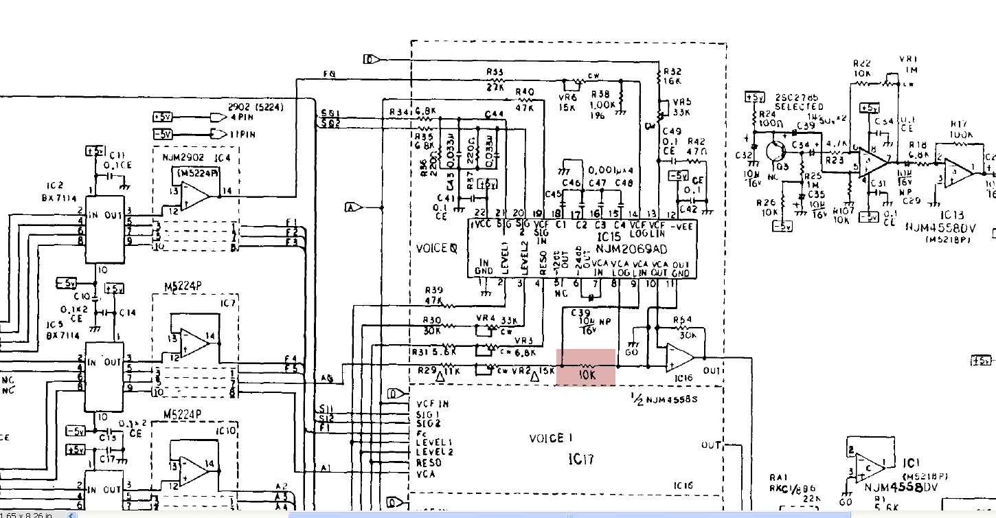

No. The feedback resistor (R54?) for the output op amp would have to a higher resistance value. IE: 30k to 50k
On Wednesday, July 23, 2014 9:11 AM, "mpigott2@... [vintagesynthrepair]" <vintagesynthrepair@yahoogroups.com> wrote:
>[Attachment(s) from mpigott2@... [vintagesynthrepair] included below]
>Would the highlighted resistor be the one that needs to be changed on voicw 1 to 6 in order to boost the audio output?
