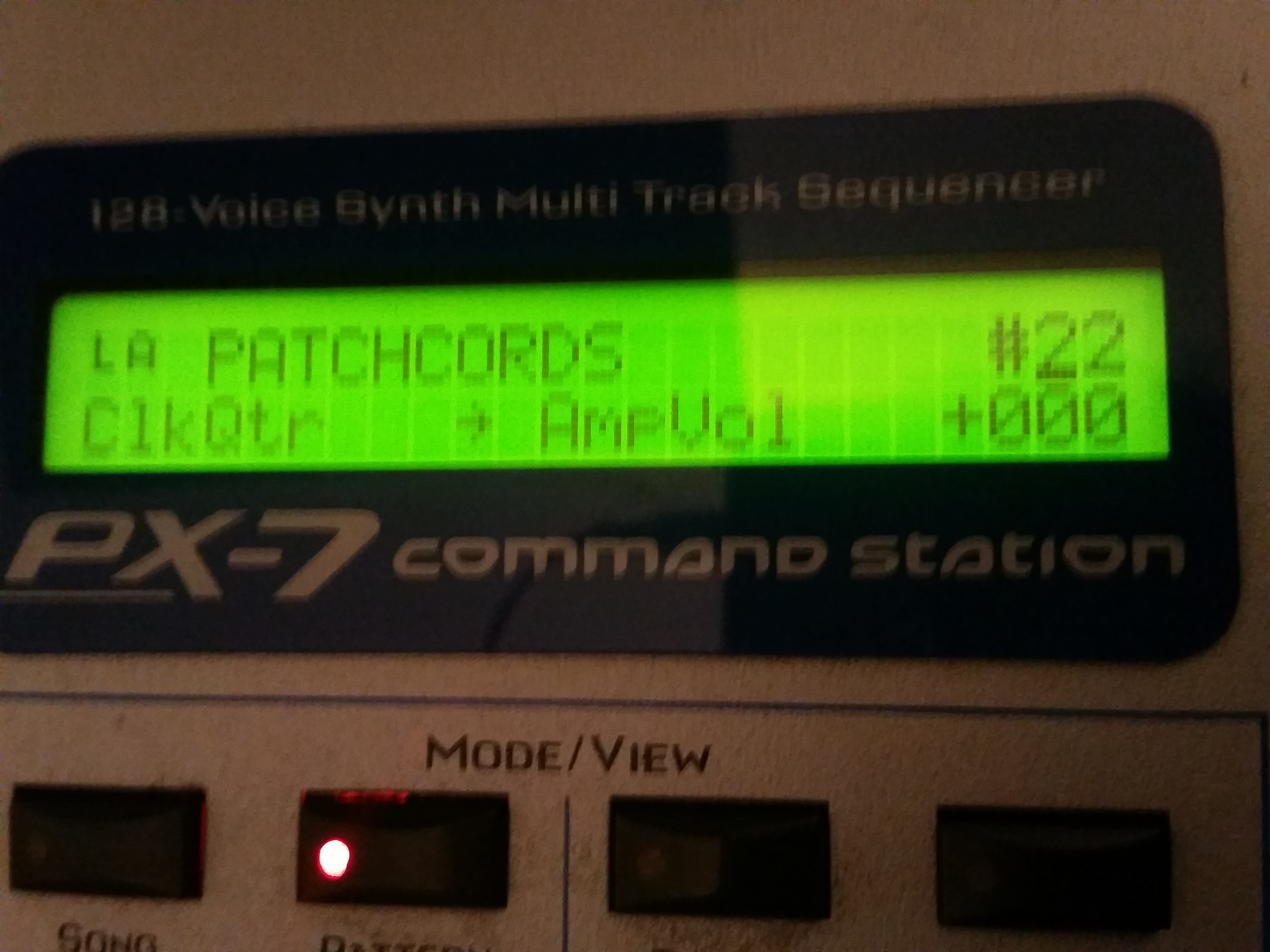

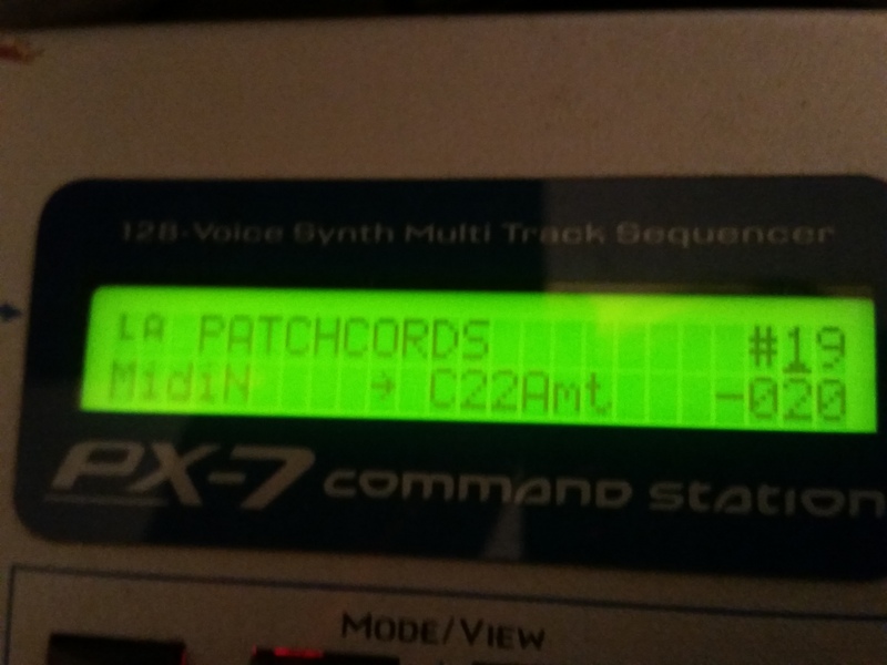

Thanks! That was a bit too simple for my taste though; a raw square wave modulating the volume doesn't really sound like a side chain compressor because there is no attack/release. Perhaps something could be done with the lag processor but I doubt it.If only the LFO saw wave had started from minimum...
