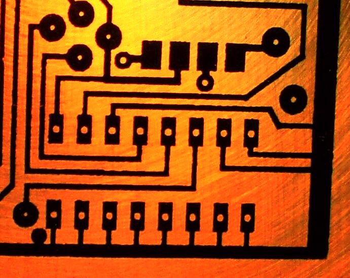

John Snyder:
Photo of a part of a cold toner transfer.
Technique is as shown in the YouTube video.
Not perfect, but equal-to-or-slightly better than what I can get with hot transfer.
The important part for me is that it took me about 10 minutes to do the complete
operation, including a warm water rinse to peel off the paper backing.
And the process seems to be not as hit-and-miss as my hot transfer work.
I have not etched any of the boards yet, but I don't anticipate any problems.
I will use muriatic acid and hydrogen peroxide in a 50 to 50 solution.
I don't own a laser printer, so all of the laser copies are done at a local
quick copy shop.
I have no idea what type of toner they use or what kinds of printers they use
except that the laser printers a BIG machines. I supply the paper.
Of course, this photo is much, much larger than the actual board (about 8X), but it does serve to show detail of transfer.

Thank you for the help and demos, Roland. Good looking transfer!
