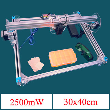

The only annoyance in Pcb making for mw now is the lack of thoughole plating!
And the fact that I have to use 2 machines
Hench why I just bought one of these off banggood to which I'll stick a pcb drill on a diy z axis so I can laser and drill without moving pcb
Not bad for $215
