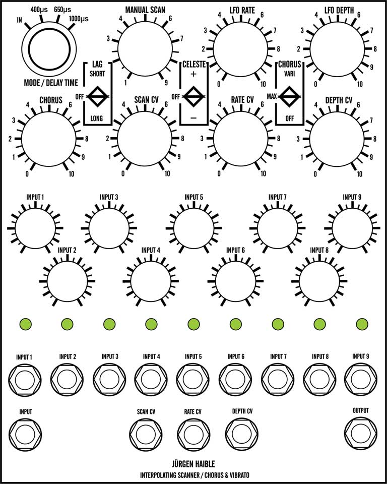

Re: JHaible interpolating scanner / Vibrato / Chorus panel finalized...
2009-04-21 by wjhall11
Oh - I accidentally sent the note I'd jotted to Scott Deyo about a possible one-off panel for Will and me to the whole list.  Sorry about that.  But I was going to mention it to the list as well eventually.  Scott Juskiw's mods and feature set are great.  And Will and I had looked the IS/CV over just the day before to try to get a really good grasp on the combo module.  We hadn't realized that Jurgen had even put a lot of notes about combining the two implementations on his site... we hadn't looked at the page for - oh - three or four months or so.  We'll start a construction page, but we won't get to building ours until Scott D has time to make the panel.
--- In ModularSynthPanels@yahoogroups.com, William J Hall <wjhall@...> wrote:
> Hi Scott...
> Seeing Scott Juskiw's implementation of the IS-VC combo module gave me
> the info to finish Will and my version.  So we'll implement ours just
> like Scott J did - same features - we'll use his mods - just the 4U
> panel.  We just don't like the jacks up the left side... we want them at
> the bottom on ours.
> OK - Thanks.
> Bill and Will
Re: [ModularSynthPanels] Re: JHaible interpolating scanner / Vibrato / Chorus panel finalized...
2009-04-22 by Scott Juskiw
But your 4U layout will probably win over more people in a "battle of
the panels". People seem to prefer the larger knob versions. I can
smell another vote coming on...
> panel.
2009-04-22 by wjhall11
Well - that may be, but Your 3U version certainly saves space.  And that's something we're running out of.  I think there are advantages to both.  Really, the motivation for our version was to get the jacks across the bottom and so their control knobs above them.  We're using the smaller, PKES60B1/4 ALCO knobs for the nine input controls, after all.
An advantage to this layout is also that most of the knobs and jakcs and LEDs line up horizontally on the standard MOTM grid.  If one increased the panel to 5U, you could get them to align vertically with other modules as well... but that seems silly to us.  In my experience, its horizontal alignment that has the greatest visual impact.
But also thank you for correcting our design - we've altered it now to accommodate the 1-1/2" diameter of the switch with its solder lugs by moving it down and to the right side.  On our diagram, that 1-1/2" is represented now by a dotted line.  And we made the corrections you very graciously pointed out to the switches, etc.
I can't figure out how to attach the drawing to this posting...
I'll mess around with it a bit.
Thanks Scott J!
Bill (and Will)
2009-04-22 by William J Hall
I'll do it this way... thanks. Bill
Yes, saving space. That's exactly why most of the things I've built in
the last few years have been using small knobs. Not because I like
fiddling with tiny knobs, but just because I've run out of space.
Something I forgot to mention about the scanner (but will add a note
on my website) is that there's little point in using the 3 headers to
connect the rotary switch to the PCB if using the "all in one"
implementation because it requires an additional wire between the PCB
and rotary switch that is not on any of the headers. I originally had
the 3 headers on my PCB but was able to remove them (without
destroying them) when I realized this. So save yourself the hassle and
expense of those 3 headers.

JH Varislope Filter Panel
2009-06-16 by Scott Juskiw
I plan to build the JH Varislope Filter in July and have been putting
together a few modifications as well as trying to figure out a panel.
This filter can eat up a lot of panel space, especially with the
onboard morphing LFO, thus I'm leaning towards small knobs in the
hopes of getting everything to fit into 3U. I've posted a few examples
to get some feedback from the group.
The first layout uses 3 switches to select all-pass/low-pass for the 6
filter stages (as JH did with his prototype):
http://www.tellun.com/varislope_panel_1.gif
The second layout uses 6 switches, which makes things quite tight, and
I had to move the AUX input jack (for the LFO) off the grid:
http://www.tellun.com/varislope_panel_2.gif
The Clean/Dirty switch is marked "C/D".
Both layouts are still quite dense and I had a tough time figuring out
where to put the switches. The pot and jack spacing is similar to the
spacing on my JH Scanner panel so I know the pots and jacks aren't too
close. But the 3 switches in the centre of the panel may make
accessing the nearby pots a bit cumbersome. I'll have to cut some
plastic and try it out.
I want this filter to have a similar interface to the standard MOTM
filters (3 audio inputs, one audio output, 2 FM inputs [one with a
reversing attenuator]) and have the following modifications planned:
1. Add a summing amp to support 3 inputs with 100K log pots (for 100K
input impedance).
2. Add an inverter to the MOD1 input so that the FM1 pot is a
reversing attenuator.
3. Skip the MOD3 input (3 external mod inputs is more than I need,
especially with the built-in LFO).
4. Add a driver to the LFO output that will support a bicolour LED
(like MOTM-320).
5. Skip the bypass switch, I've never needed one on a filter.
6. Skip the output pot, I've never needed one on a filter.
7. Change the output driver so that the Mix/Filter switch is not
required to completely silence the Dry signal from the output.
These modifications require 4 op-amps. It'll fit nicely onto a MUUB-4
board, spookily enough.
Re: JH Varislope Filter Panel
2009-06-19 by djbrow54
Nice set of enhancements.  I agree with them all.  I was working on a 3U panel myself with the small potentiometer spacing but like yours better.  I adapted a version of it in FrontPanelExpress at
http://modularsynthesis.com/jhaible/varislope/varislope.htm
I've used this smaller control spacing on my YUSynth fixed filter bank with a switch in between. It's tight but very usable.  There is a photo at the bottom of this page showing the spacing.
http://modularsynthesis.com/yusynth/ffb.htm
Nice work. - Dave

Re: [ModularSynthPanels] Re: JH Varislope Filter Panel
2009-06-19 by Scott Juskiw
Thanks Dave, that looks good. I like the waveforms around the WAVE
knob and moving the Clean/Dirty switch in line with the APF/LPF
switches. You don't think the AUX pot and jack are too close? I find
the biggest annoyance with designing a circuit is getting everything
to fit nicely into a panel. It always seems that you've got just one
jack or pot too many (i.e. if that AUX pot wasn't there then the two
invert switches could be moved in line with all the other switches).
Oh well, I'd rather have the option than not.
I'll post a schematic of my circuit mods once I get this built (not
that you need it, the mods are quite simple, but maybe someone else
would like it). Maybe we'll see a BrideChamber version of this
someday. Is there a 5U big-knob version of this coming down the pipes?
(nudge nudge Bill & Will)
> Nice work. - Dave
2009-06-20 by djbrow54
It's tight, but I used that spacing on my Chorus and Interpolating Scanner - basically 2 jacks and 2 potentiometers across a 2U panel.  I'd rather have it tight then go up to the next size panel.  I find that I turn the knobs with just two fingers so the cable in the jack on the right fits into the "cup" of my hand.  Besides, I don't think the Aux control will get used that much.
I made a few more tweaks to the center switches.  They almost line up with the top legends so I shifted them slightly and just used a horizontal line to tie them to the controls.
Now to see if I still have that spare MUUB-4 board ...
Dave
