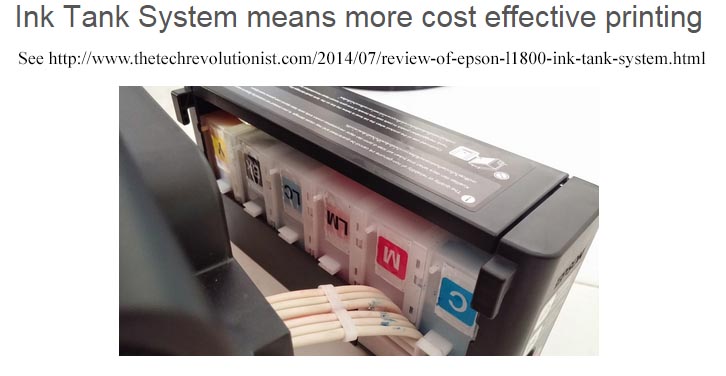

Sadly Epson does not market these hextone 1.5 pl printers in the US.
It looks like the tank is easily detached from the printer for agitation.
> See
> http://www.thetechrevolutionist.com/2014/07/review-of-epson-l1800-ink-tank-system.html
> or
> http://www.paulroark.com/BW-Info/Epson-L1800-printer-tank.jpg
> What profiles did you use?
