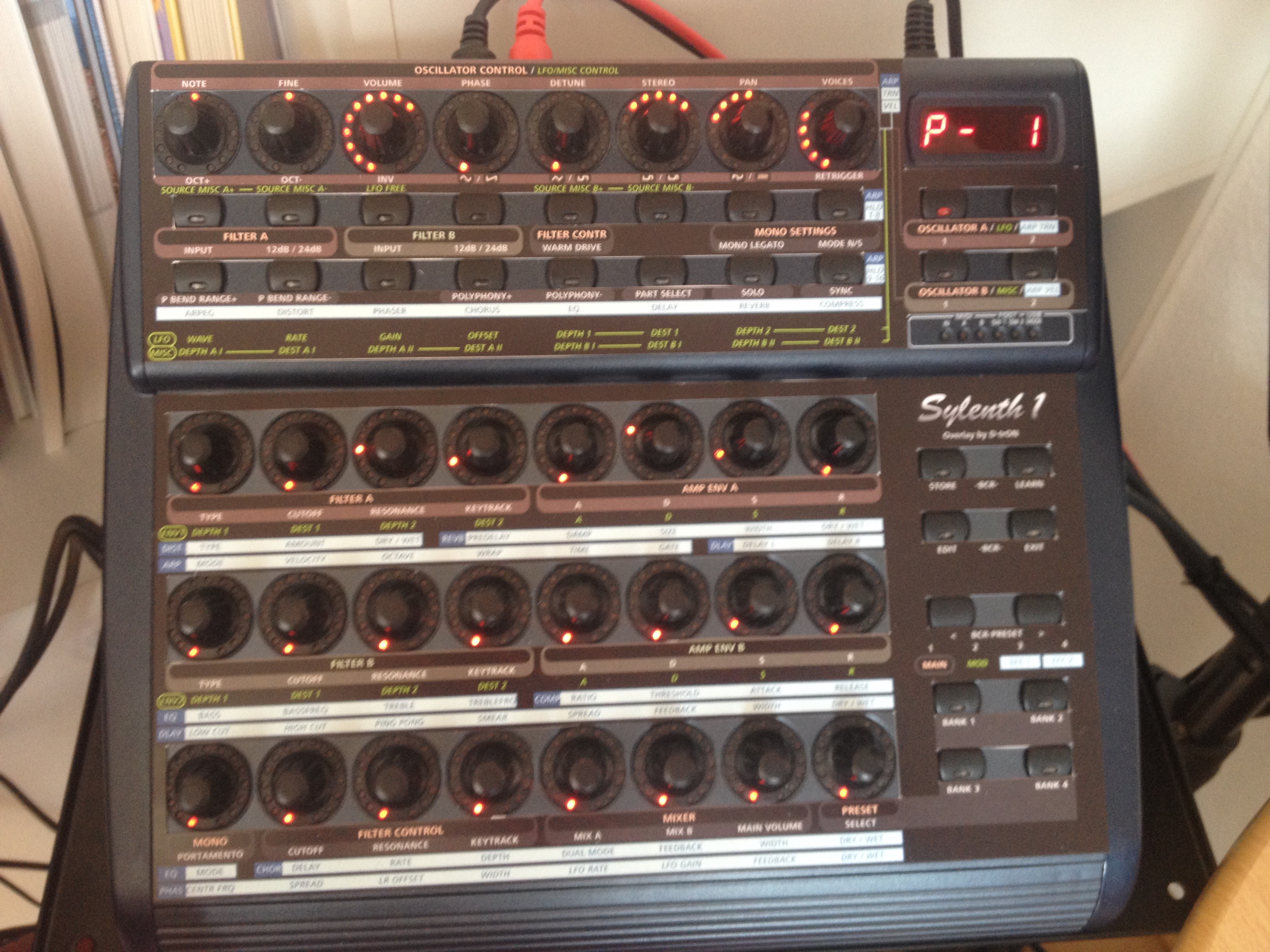

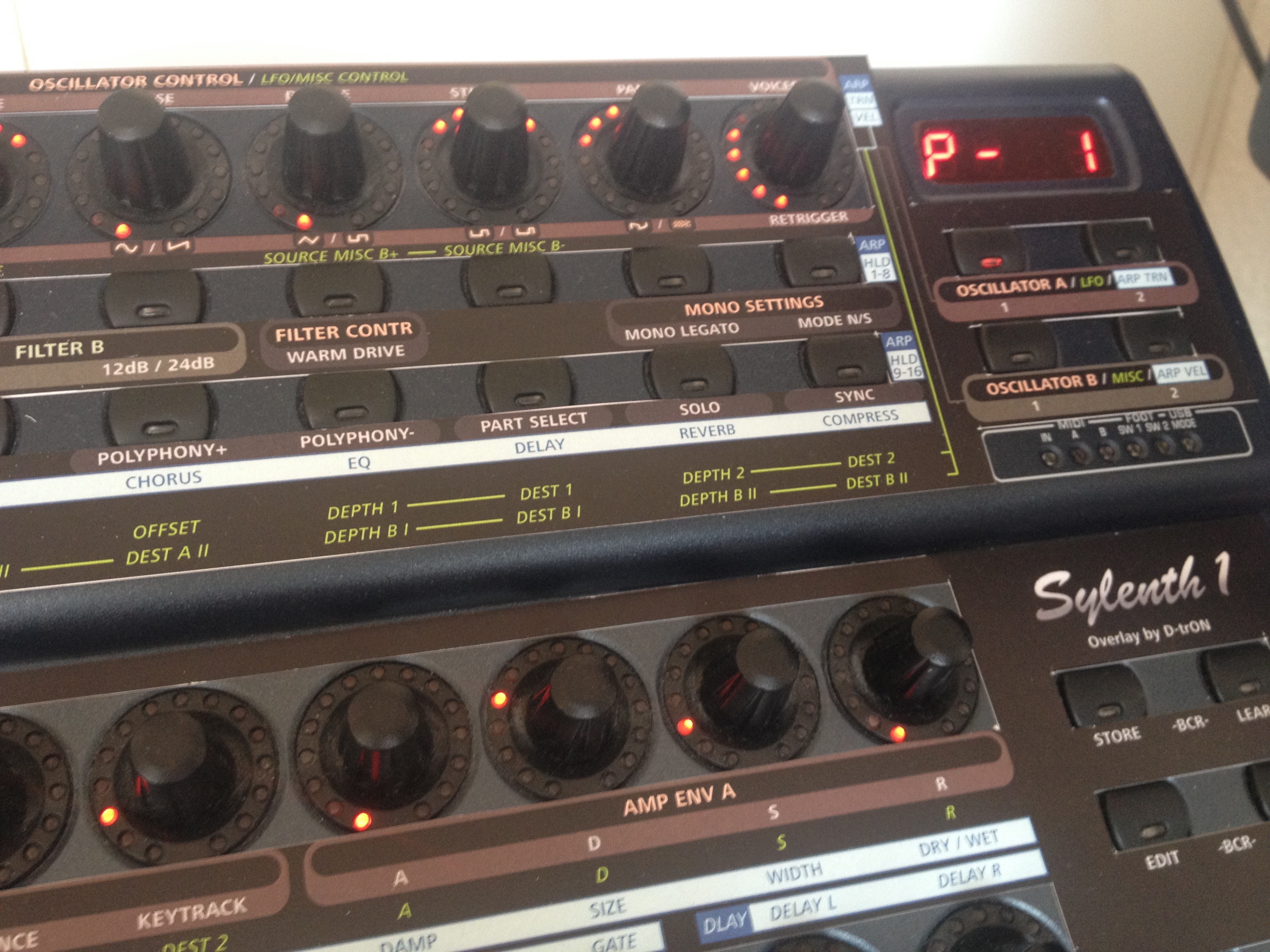

My Sylenth 1 has turned into a hardware synthesizer: I did a full mapping (250 parameters) with a BCR. Everything on knobs and buttons, no mouse needed. Implementation via NRPNs, configuration saved directly in Sylenth (and BCR obviously), so everything directly available at start up, host automation not touched (but of course still usable). Double the fun now, getting lost in sound tweaking

Do you use Sylenth1 in standalone or in your Daw?
I did the same mappings but was limited to cc numbers. Layout on 2xbcr2000. Are you willing to share your template daniel?

Fantastic work!
I'd love a copy if you're going to make it available anywhere.

Hi Jan,
I am using it in a host that correctly transmits NRPN, in my case Mainstage (which I have linked into Ableton). (Note: Ableton does not work yet, because it cannot handle NRPNs correctly plus it does not save the midi configuration per plug-in. Ableton told they are going to fix that ... ).
I am happy to share the files (will pull them together during the next days and then send them to you). I prefer personal sharing (i.e. sending via e-mail) and feedback rather than just posting it in some file folder. So anybody who is interested, please drop me a message.
