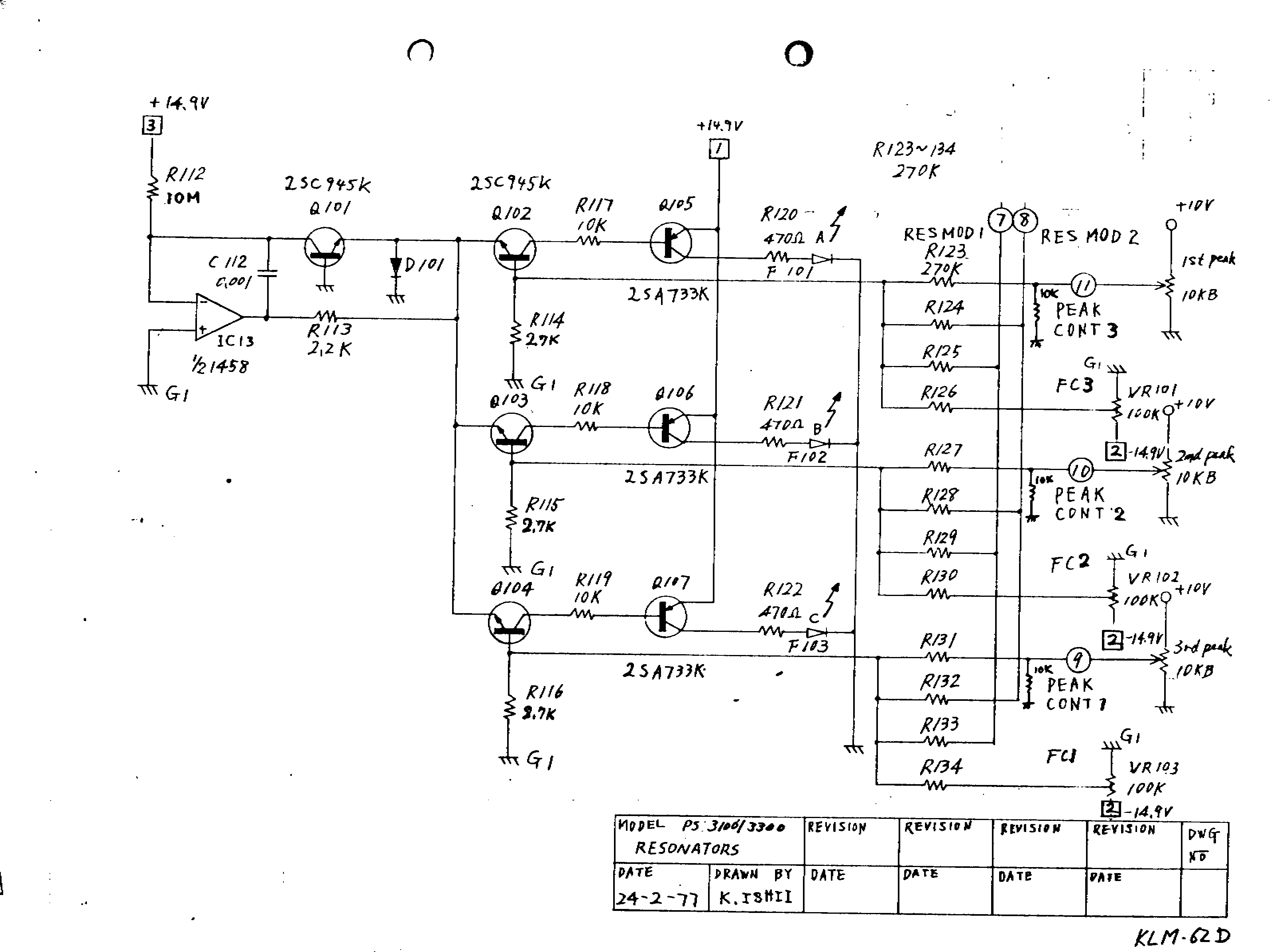

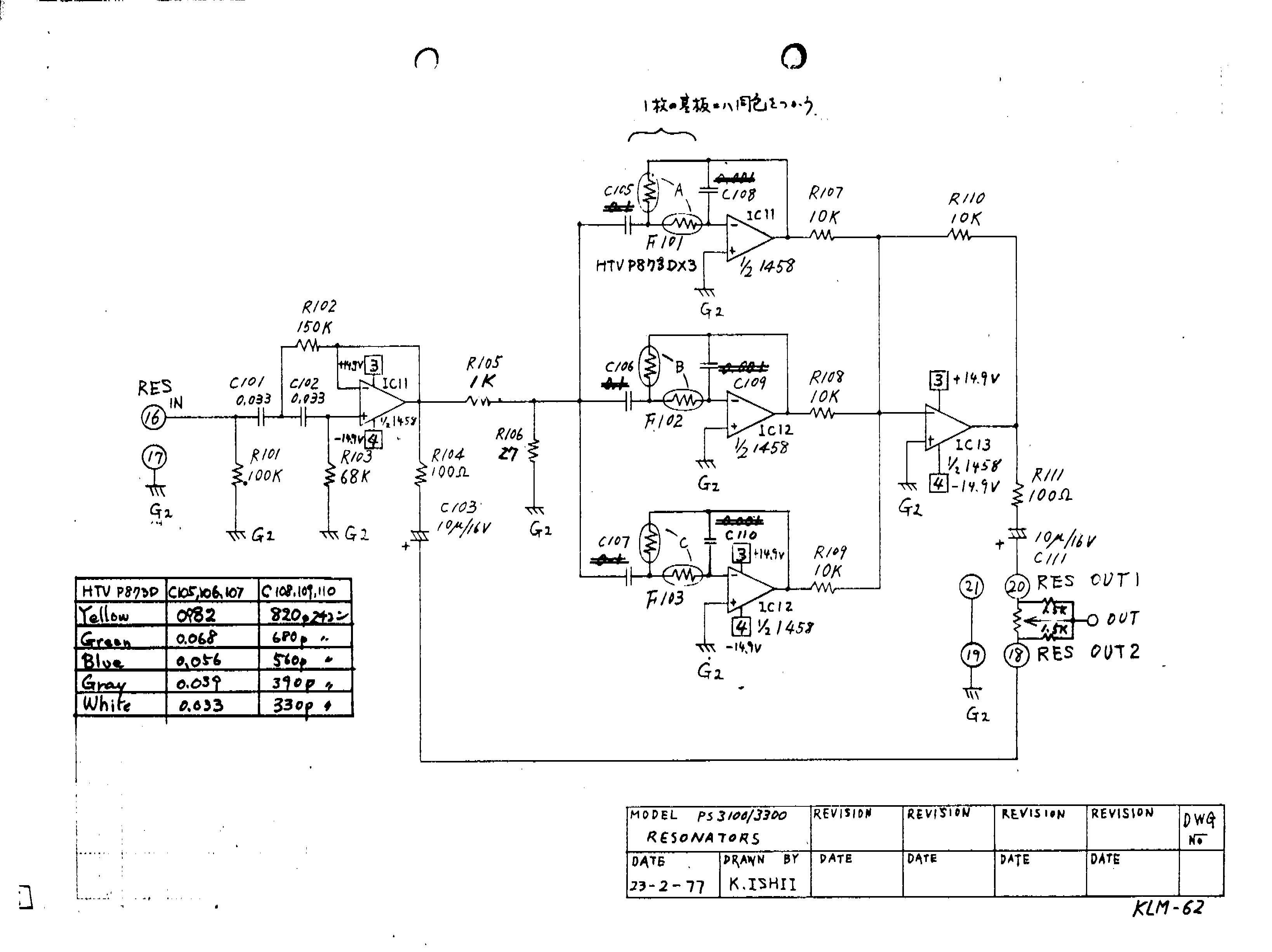

why not built the tripple resonant filter from korg ps3100. I expect
that is where the doepfer one came from? lots of people build this
circuit, I plan to do so as soon as I finish some other things. Listen
to samples on scott stites page or the synthtech page to hear it. that
one uses vactrols to give VC control.
i couldn't remember where the schematics were posted so I put them up
here for now:
http://www.sdiy.org/destrukto/temp/korg_ps3100_resonator1.png
http://www.sdiy.org/destrukto/temp/korg_ps3100_resonator2.png
-ryan

The usual trick is to use OTAs instead of the op-amps to vary the frequency,
and as OTAs don't use the same physical or electrical configuration, it
would get ugly. Now if you are simply wanting to do the triple resonant
filter and don't care about accurate tracking, some possibilities do open
up. Basically, you replace the dual 100k pot with a pair of vactrols in
parallel with a couple of fixed 100k resistors. The current through the LEDs
will now control the frequency.
