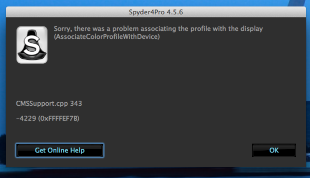

I just booted up a new iMac 27" off of a backup disk from my 2013 MBpro laptop. Trying to calibrate for the first time, and getting this error message at the end. Maybe it is missing files?
Anything I can do?
I don't' have a disc drive on this machine, but is it possible to redownload the software and try the spyder again?
Thanks!
Re: [datacolor_group] Error using the Spyder4Pro on new iMac [1 Attachment]
2014-01-15 by Cdtobie
First, try changing the default profile to sRGB, and see if that solves the issue. If not, download the installer, and reinstall. If that fails, submit a support ticket at datacolor.com.
