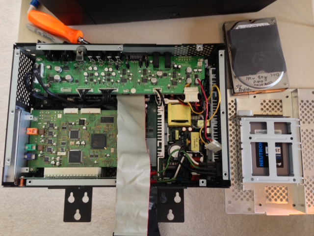

Emboldened by Ken's experience, I set out to do the same thing… upgrade my Mark IV's slow and small and a little noisy IDE drive and replace it with a bigger, silent, cooler SSD drive. I picked up a 128gig Transcend SSD from Amazon… ~$175
Note that you will also need a mounting kit, as 2.5" drives do not just fit into 3.5" drive bays… but a conventional "Adapter-Kit-to-Mount-25-HDD-in-35-Drive-Bay" (google that) works perfectly, no holes to drill, and that comes with the cable to convert the 40-pin SSD connector to a conventional 44-pin IDE connector.
Note that the unit is secured to the bottom of the piano with a very simple but very TIGHT set of screws. If you're using a power tool, especially one that doesn't have variable speed, you'll probably want to loosen the screws by hand… otherwise you risk stripping the heads. Kudos to Yamaha for doing it right, there was zero chance of vibration/rattle when it's mounted like that. Interestingly, I had a little trouble unmounting the HD as well; those screws were not only tight but, get this, GLUED as well. When I removed them, a dry ring of glue came out of the screw holes. I've never heard of doing that before, but I guess they wanted to be totally sure that drive wouldn't rattle/vibrate at all.
Unlike Ken, I didn't just clone the drive. I know my way around Linux well enough to do what I set out to do, which was create an image of the original drive, copy the image onto the new SSD and then extend the partition on the new drive where data is held.
I was expecting a hassle when I plugged in the drive to my computer via an IDE enclosure but was pleasantly surprised that the drive is partitioned in completely normal linux partitions with conventional file systems (with the exception of one partition that I couldn't read). The beauty of creating a disk image is that you don't need to "read" the data, just be sure you've made a faithful copy, which I did. It was therefore trivial to grab the contents of the original drive, apply that image to the new drive, and simply extend the data partition (it's not hard to tell which one that is… it's the last and biggest, and if you look into it, you'll soon find sound and midi and audio files.
Oddly, one of the partitions (partition 5) is unreadable, or at least was unreadable to my OS. I'm not sure why, but it doesn't really matter. As long as it's identical bit-by-bit, something will know what it's for. Once I'd finished creating the new SSD, I tried booting my computer with it and was happy to see it fire up. Of course it crashed when it couldn't find the piano hardware, but as anyone who's ever messed around with this sort of stuff knows, getting it to read and execute the boot sector is 95% of the battle. I was delighted to see the new, silent, cold drive do its thing… and once in the piano, it booted flawlessly.
Indeed, now I hear chirping when the piano silently boots up…either the CD or FD drive… and after that it's silent. And FAST, super fast… it's no illusion, the menus on the PRC are instant. Note that I had to completely reset the PRC once the new drive booted… since some internal variables on that unit must get set upon initialization, having the piano change completely confused the poor little PRC, and I started getting all sorts of "out of range" Java errors. No worries, pull the battery and wait a few seconds… all is good.

Mark IV Hard Drive Upgrade Pictures
2013-07-08 by carwizard
Here are SSD Picts

Fwd: [disklavier] Re: Mark IV Hard Drive Upgrade
I used a 256 Gig SSD drive. Here are some pictures. I had trouble with the Samsung drive. It hung up during adding music.

Re: [disklavier] Mark IV Hard Drive Upgrade
2013-07-09 by Horatio Kemeny
I used a 128gig Transcend SSD from Amazon… ~$175 at the time, certainly cheaper now. I'd get a 256 as well (not available at the time). Get an IDE and you will avoid the SATA/IDE adapter issue.
