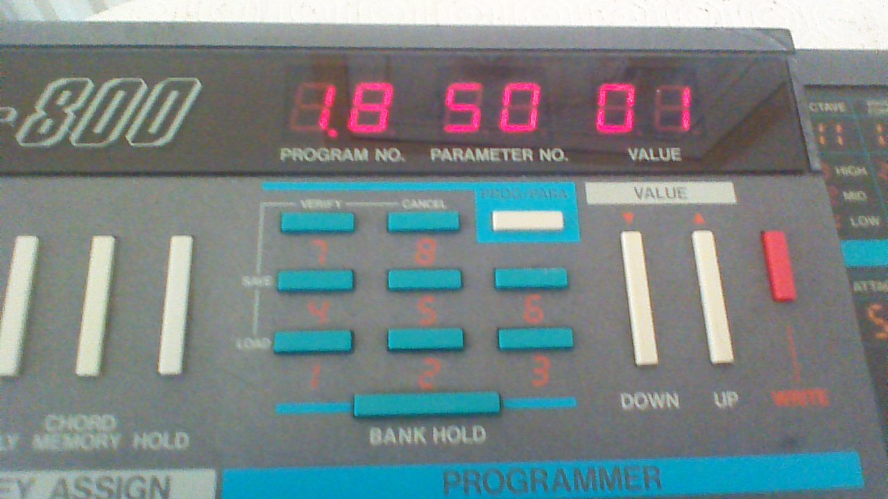

I bought a Poly800 last week which worked: I was able to load the factory presets via a .wav file and most of the keys worked. I repaired the keys by cleaning the contacts.
While I had the synth open I decided to apply a battery modification which I found at this location http://analog.no/cms/index.php?option=com_content&view=article&id=50&Itemid=49
I confirmed all of the connections and tested them using my multimeter.
This mod is not the same as the one I've now discovered in the file section.
I removed C87, C88, D23 and D15. I bridged the trace at D15 and cut the trace close to C106
I have not touched R1 or D1
This is a Mk-1 Poly800 which didn't come with a memory backup battery. There are two 'pads' where the battery holder can be soldered.
When I powered up the synth it started ok and I made a simple patch to test that all the keys worked.
I then tried loading the factory presets from a .wav file played back from my phone.
The tape load failed and when I re-started the synth I got the error message 1.8 50 01 on the display (see attached image.
I'm puzzled as to whether something corrupted when I tried loading the factory presets or have I fried something while soldering?
I put all of the removed components back into the synth and re-bridged the cut trace.
The synth is still showing the same error message.
Any suggestions on what I might try next? I'd like to try resurrect the synth and fix whatever I've done.
thanks,
Peter

That looks like a sequencer step display. Did you accidentally move the sequencer enable switch on the back?
thanks,
Peter

 Replace IC34 (40H138) and while you're at I would try to replace IC33 (40H240) ..
 the integrated original cost a lot but
 for a budget you can find equivalent 74HC138 and 74HC240 for € 1 ...
 IC34 and IC33 prone to failure, however, replace immediately and solve the problem.

Yes, that's what the step sequencer looks.
You can check the sequencer switch. Check out the schematics in the files section for help on tracing the specific matrix lines that work with the sequencer enable switch.
It could be that the matrix scanning chips are no good but that doesn't happen often. If your synth is making sounds check to see if one of every eight notes doesn't work. That's a good indication of a chip problem in the matrix keyboard scanning. If all of the note keys make sounds then it could be a bit more tricky to figure out. Sometimes the DTC devices fail.
Did your Poly display like that before you put the battery conversion in place? If is was OK beforehand then I suggest you double check all of work and check for any solder fragments or blobs that may have been dropped while you were doing the battery install. Also check to see if you broken or bent any pins on the cable assemblies when you did the work. Also check for any broken wires in those cable assemblies.

    Hi Don, thanks for the quick answer. I'll double check that but I'm pretty confident the sequencer switch is disabled. It's possible that maybe the switch is malfunctioning so I'll investigate further.
I'm not familiar with the Poly800 :  is that what the step sequencer display looks like?

Re: [korgpolyex] Re: Poly800 Mk-1 Battery Mod - have I damaged something? Error 1.85001
2015-04-08 by Michael Hawkins
- maybe change electrolytic caps in PSU, after so many years maybe they need to be replaced
NO NO NO. Electrolytic capacitors from 1989 are going to be OK. Statistically, they're OK. The chances of a electro cap from 1989 being bad are very LOW. And the symptoms of the problem don't remotely sound like a electro cap problem.
Everything else is good advice. :-)
/Mike
      From: "Daniel Forró danforcz@... [korgpolyex]" <korgpolyex@yahoogroups.com>
 To: korgpolyex@yahoogroups.com
 Sent: Wednesday, April 8, 2015 10:22 AM
 Subject: Re: [korgpolyex] Re: Poly800 Mk-1 Battery Mod - have I damaged something? Error 1.85001
    Are internal demo songs OK? Do they play?
Anyhow, you can try following.
I would do this:- if machine was not used for longer time, leave it switched on through all day as long as possible, but keep eye on it all the time (danger of fire ???)
- reset (see below)
- go through test routines (see below)
- check, clean and reseat all connectors inside with contact spray
- reseat all IC's in sockets (be very careful not to bend or break pins)
- measure PSU voltages if they conforms with the spec
- check internal RAM battery, if it's dead, replace it
- load the original factory data from the ROM card if you have it, if not, send some proper SysEx data through MIDI, be it original factory set or other
Good luck!
Daniel Forro
P.S.: Isn't this KORG group?
2015-04-09 by Daniel Forró
Hi, Mike,
I know opinions on recapping can differ, so there's two times "maybe".
In all cases it can't be a mistake to check how they look.
I have included PSU problem, because wrong voltages are often a
possible source of wrong function, and electrolytic caps are first to
be suspected. Not just my experience :-)
Daniel Forro
2015-04-09 by bperkins211@...
change in behavior could be a foreign conductive object in there creating chaos.
I had such a thing happen to a Kawai K3. When I moved the synth, set it down on its end a few times I heard something rattle in it.. powered it back on and the problems moved around..
finally I found a small pebble sized black ceramic looking object inside the synth.
When I removed it and powered it back on, all was working again.
Look for something where boards might be stacked close to each other.. something could be sandwiched in between, as was in my case until it dislodged itself.
2015-04-10 by Vincenzo Vincenzo
Hello Daniel, Mike & perkins 211,
 thanks a lot for your valuable advice .. I understand that it was not the right section to discuss it and I thank you very much for the opportunity ..
 just back home in 15 days I follow the procedures that I have recommended hoping restart it ..
 I let you know the result.
hello
 Vincenzo
