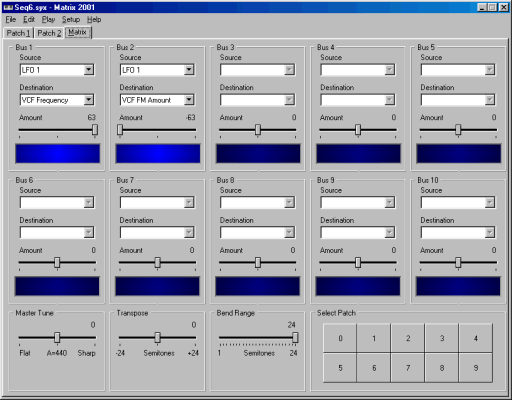

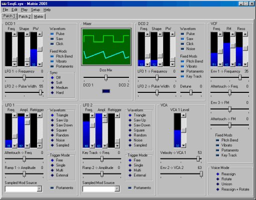

Matrix 1000 editor that works in XP or Mac OSX???
2012-08-10 by Jill Saphic
Hello Ady
thank you 4 the info and the links on the cubase and other things.
When you mention the super GUI,
does it have nice windows to see waveforms,
and matrix mod routes and things?
Do you by any chance have any screen shots lying around from your work?
