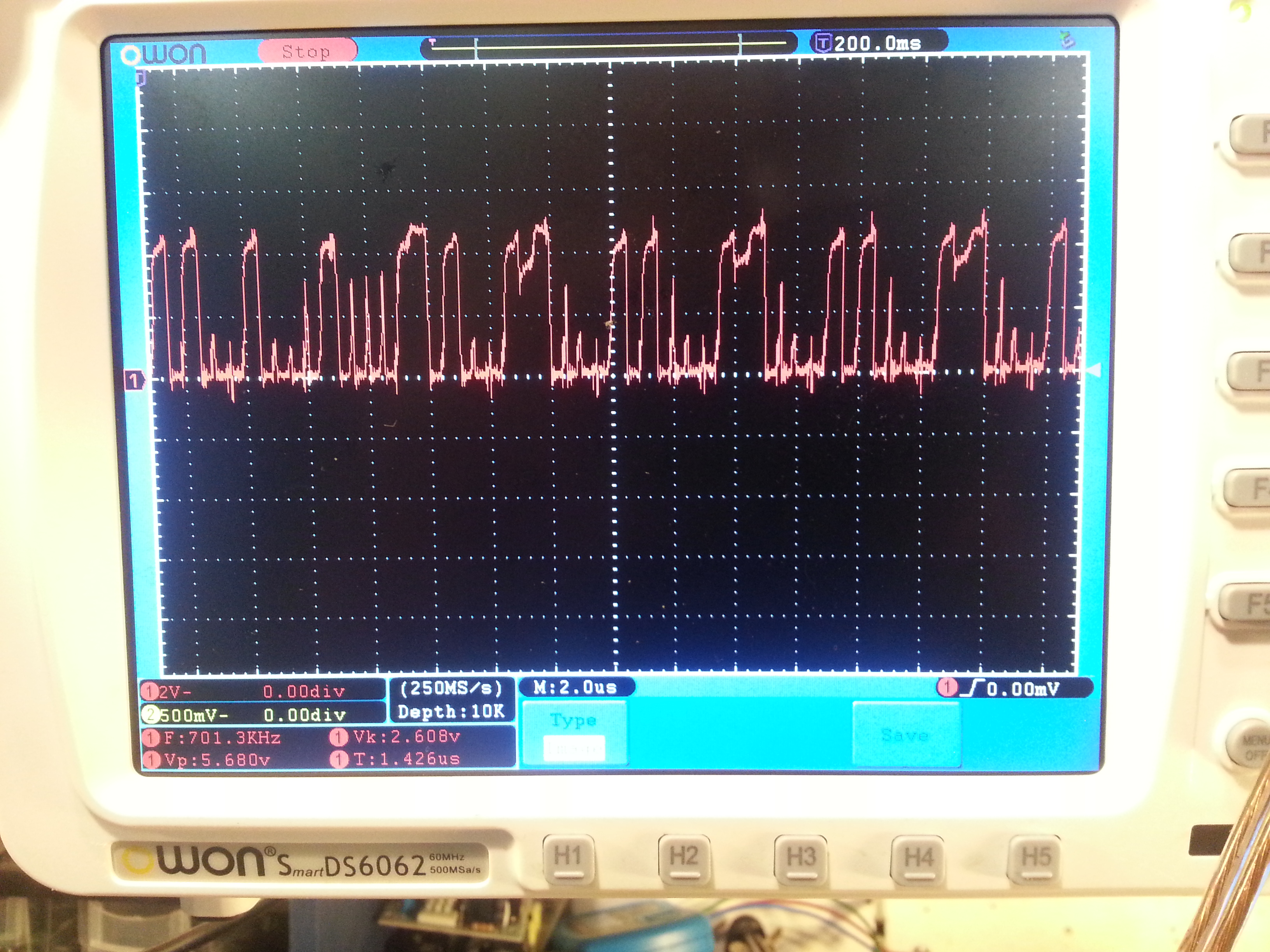

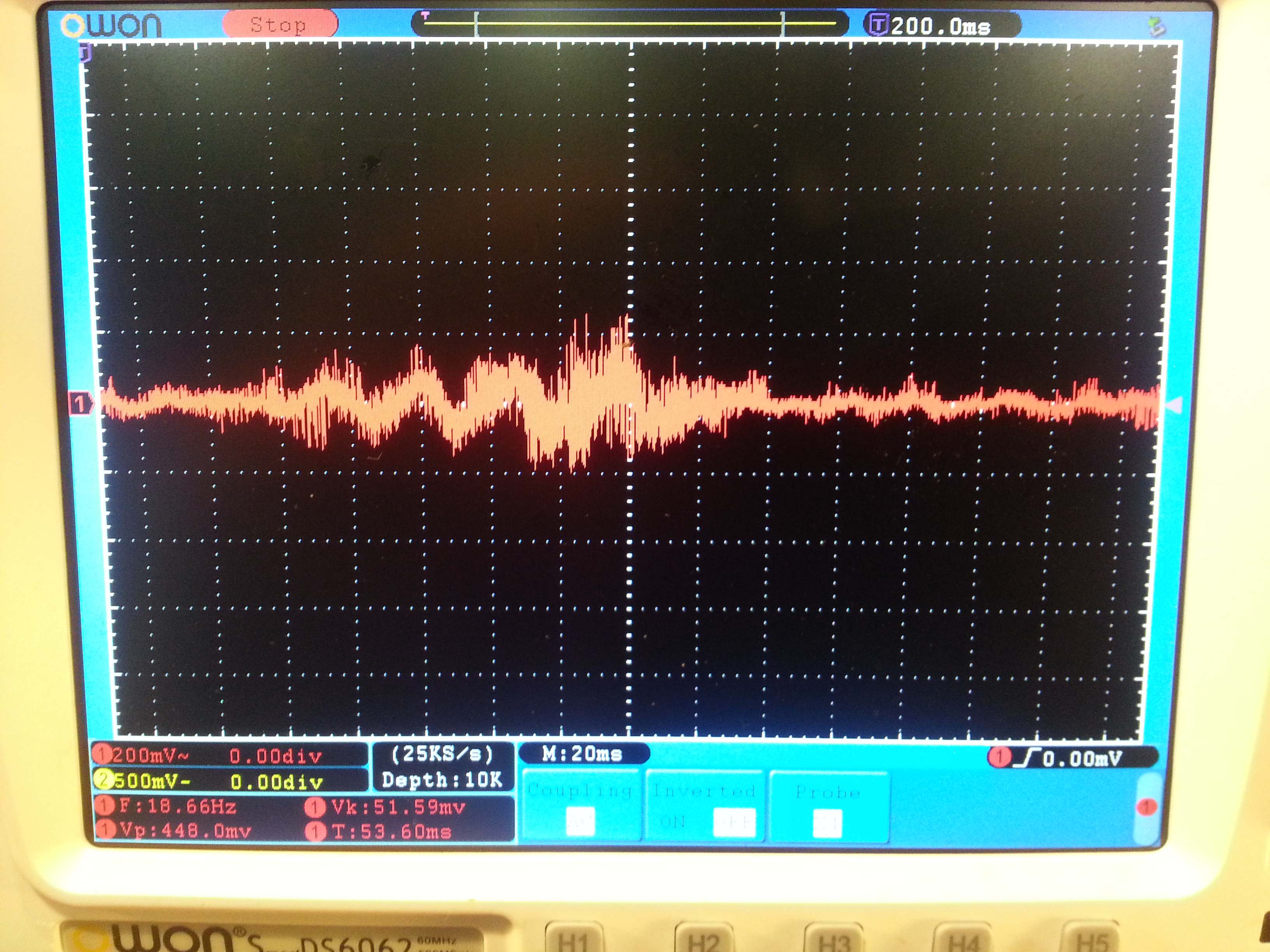

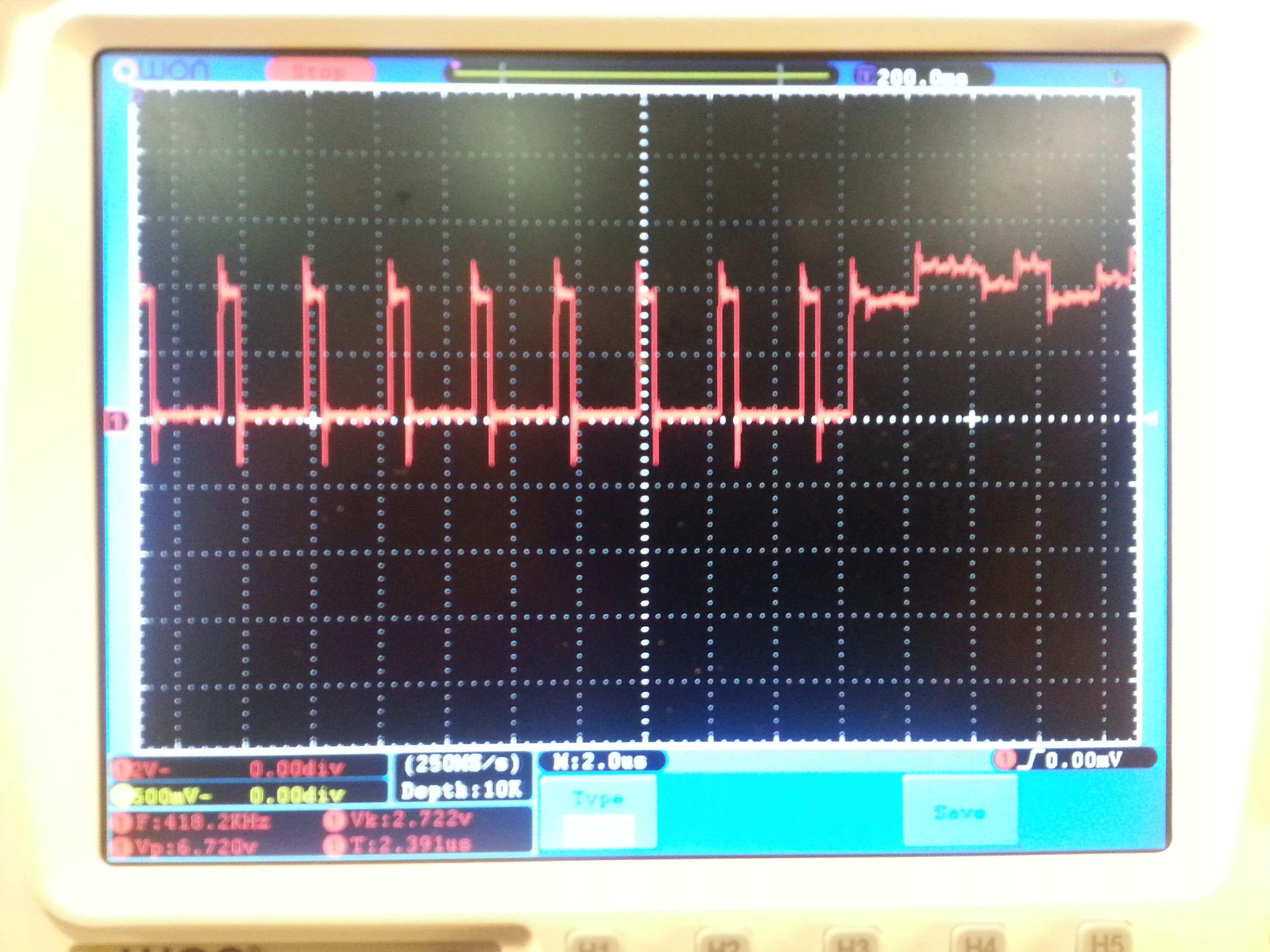

I have recieved the new dac, put into place, made calibration but still same problem.
I have attached scope picture of the 5V supply, U903_pin4 and U904_pin2 to show signals.
There is this kind of burst on the 5V supply.
The signal on U9 04_pin2 look awfull.
Any idea what could be wrong?

>The signal on U904_pin2 look awfull.

Hi Nick, with the DVM all is fine. But with scope you can see on the 5V supply some kind of burst. See my last post with attached scope shots.

2014-01-19 by Bob Grieb
Hi. Most synths have separate digital and analog power supplies, to keep the digital noise from the logic circuits away from the analog sound circuits. If the noise your picture is showing is on the 5v digital supply, I dont think it should be a problem. It looks like maybe 150mv or so pk to pk? There will
Always be some noise on the digital rails.
Bob
