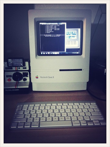

It will not run on a Mac Mini. That old version of Sound Designer is meant to run on Mac OS 7.1 or so. Plus there is no point to run Sound Designer with the new Prophet 2000/2002 editor and E-Synthesist's Prophet Tools. They are far more powerful and faster and reliable.
http://synth.curlsystems.de
http://users.skynet.be/emxp/P2K.htm
Trust me, I know. I have 7 old vintage Macs right now and the old Sound Designer for the Prophet 2000 can't touch the new tools.
If you have to have the best of both worlds you can put a Mac Mini like I did in an old Mac case. Not a cheap or easy project but it can be done. (see pic) There is a Mac Mini in that Mac Classic II. You can see on the screen that I am running EMXP under Windows 7 under Boot Camp.

> On Wed, Oct 17, 2012 at 7:21 PM, James Ulibarri wrote:
> > [Attachment(s) <#13a6fbe8db854dee_TopText> from James Ulibarri included
> > below]
> >; Designer with the new Prophet 2000/2002 editor and E-Synthesist's Prophet
> >; http://users.skynet.be/emxp/P2K.htm
> > On Wed, Oct 17, 2012 at 9:34 AM, awivhsh <;pierre.ruiz1@...>wrote:
