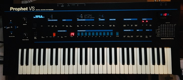

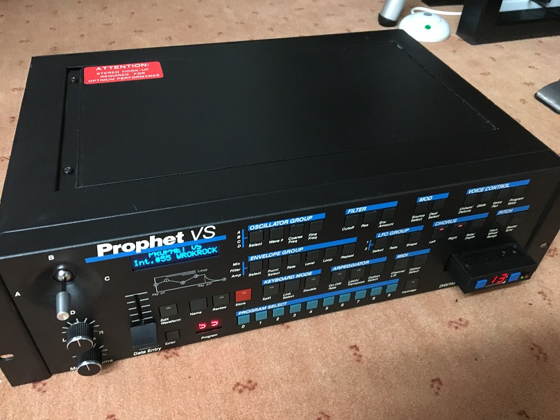

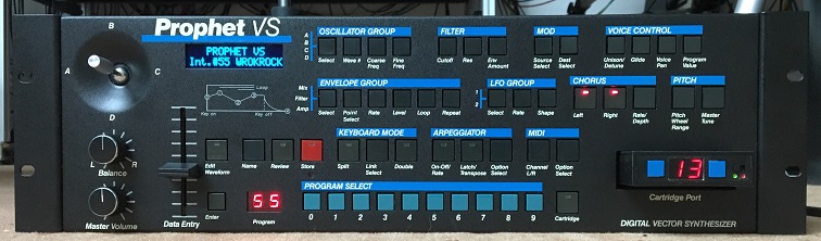

Hello to all Prophet VS users.
Here some Pictures of my new created 16 x Ram Card.
Hopefully they are visible otherwise i will try to upload them into the Files section.
It has a double 7-segment display, Up and Down buttons, a memory protect
slider.
Slider position at green dot = Protected
Slider position at red dot = Writes possible.
Pressing both Buttons simultaneously saves the actual selected Bank
as preselected Bank for Startup VS or when you slide in the Card.
