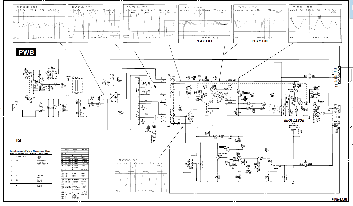

Dislavier Owners and Techs.
I have looked at every possible “outside of the power supply” reason for this and I can’t see anything that is out of the norm.  That brings me back to the power supply.  I need to test this under lode.  Does anyone have the specs for how much amperage that each of the power supply connections is supposed to deliver under lode?  I would like to do it on the bench.  Otherwise I will disassemble the power supply enclosure, and test it while in operation.  Operational test voltages and temperatures would be appreciated.
Brad
