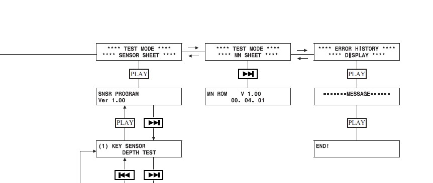

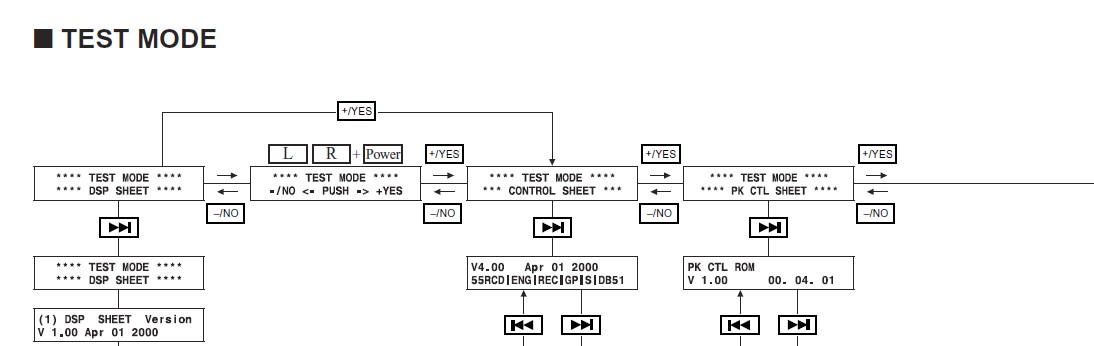

Please check the error history in the test mode.
