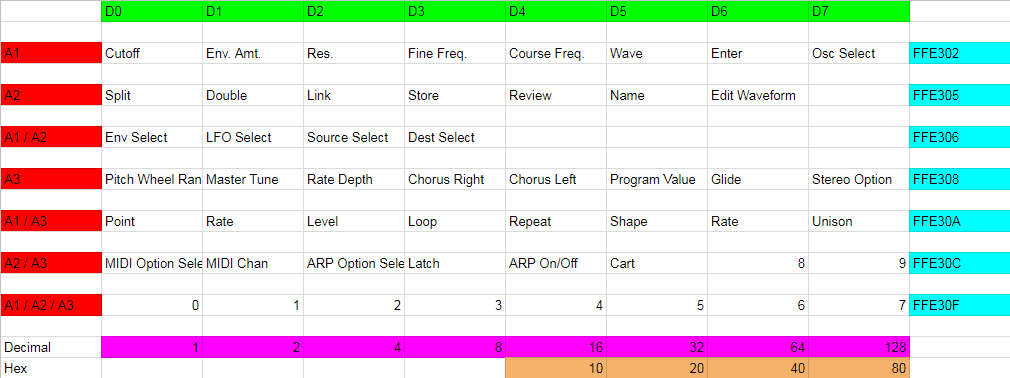

Here are some v1.3 updates:
Most of this would be way easier if I could rearrange the code without having to change the branch cross references in the entire thing. As it stands I am using empty space at the very end of the eprom.
Figured out most of the panel switch addressing, then coded a way to enable key-synced LFOs while holding down a button ("Enter" for example).
Then, I started using memory addresses basically at random to get the "enable" to latch. This will take some time... My first memory area would disable key-sync LFO if you hit the Mod Dest button. The second choice would disable if you edited Wave C's fine tuning. With the memory address I'm using now i have not found the bug yet, but it is probably there...
Now for cool stuff... As it stands presently, I can hold "LFO Select" and hit a key... key-sync turns on. Hold "Cartridge" and hit a key, it turns off. The buttons are totally arbitrary and can be changed to anything. The amazing thing though is that right now it SAVES the selection PER PATCH.
There's bound to be a bug somewhere since I'm shooting blind with memory addresses, but it is neat nonetheless. Once I burn some eproms to test on my hardware VS I'll post a video.

Since I knew that the beginning of the code would have the diagnostic routine based on holding "0+2" I looked for any cmpi commands. This is what starts the diagnostic mode:
cmpi.b #5,($FFE30F).w
Then I figured out that whole row from the binary: 0=1, 2=4, so it is seeing if 5 is there. The rest was relatively easy. See the attached image.

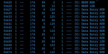

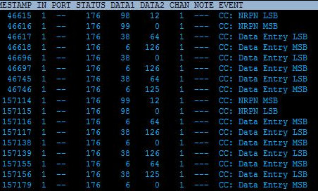

NRPN messages are well on the way to being fixed. The attached photo is the original OS (top) vs new (bottom). The MSB/LSB transmit/receive has been swapped but the data has not. Working on rearranging the code presently to fix that. Thanks for the initial tip Jari!

So, I got the NRPN out messages to be correct by rearranging the code (see image). It looks like it was only the output messages that were flipped though.
Flipping the input bytes breaks the incoming message and no NRPN codes work. In fact using original 1.0 & 1.2 eproms it looks like the VS already read the input NRPN correctly, based on watching the messages in MIDI-OX. I send it this message in this order from an Arturia BeatStep Pro in NRPN mode:
99 0 NRPN MSB
98 12 NRPN LSB
6 (*) DATA MSB
And it controls the Cutoff Freq just fine.

a regular NRPN editor will *appear* to work, but in fact is always at least one data update behind, as the VS is waiting for the MSB packet to commit the change. this packet arrives as part of the *next* parameter change packet sequence. and technically, the MSB only needs to be sent if the MSB of the value changes, so if the controller implements that, it could be a while...
i think this is why the official NRPN spec is big endian, as lots of MSB packets can be saved if only the LSB changes, which is most of the time. the VS version is more wasteful on the wire.
i found all this out the hard way, before i knew anything about the VS implementation, using an Encore Electronics Knobby to control my VS. i talked to Tony K (now chief hardware guy at DSI) about it and they actually did implement a little-endian mode in the Knobby for the VS as a result (thanks guys).
so for accurate parameter changes from NRPN controllers, the input code needs to be swapped too.

Thanks for the extra info Jason! I was working on a sort of memory map for all the patch info, but I'll go back to working on the NRPN input.
