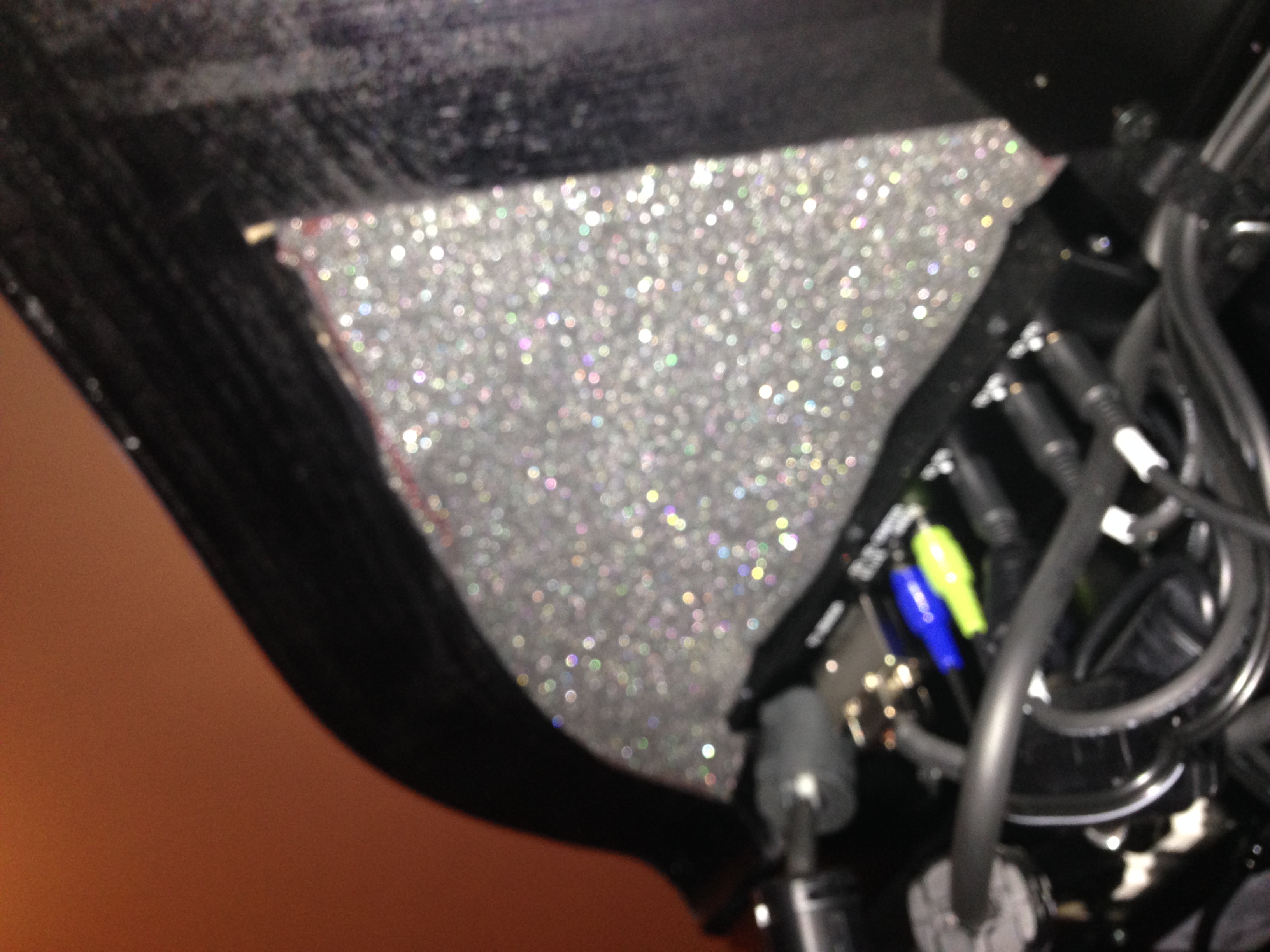

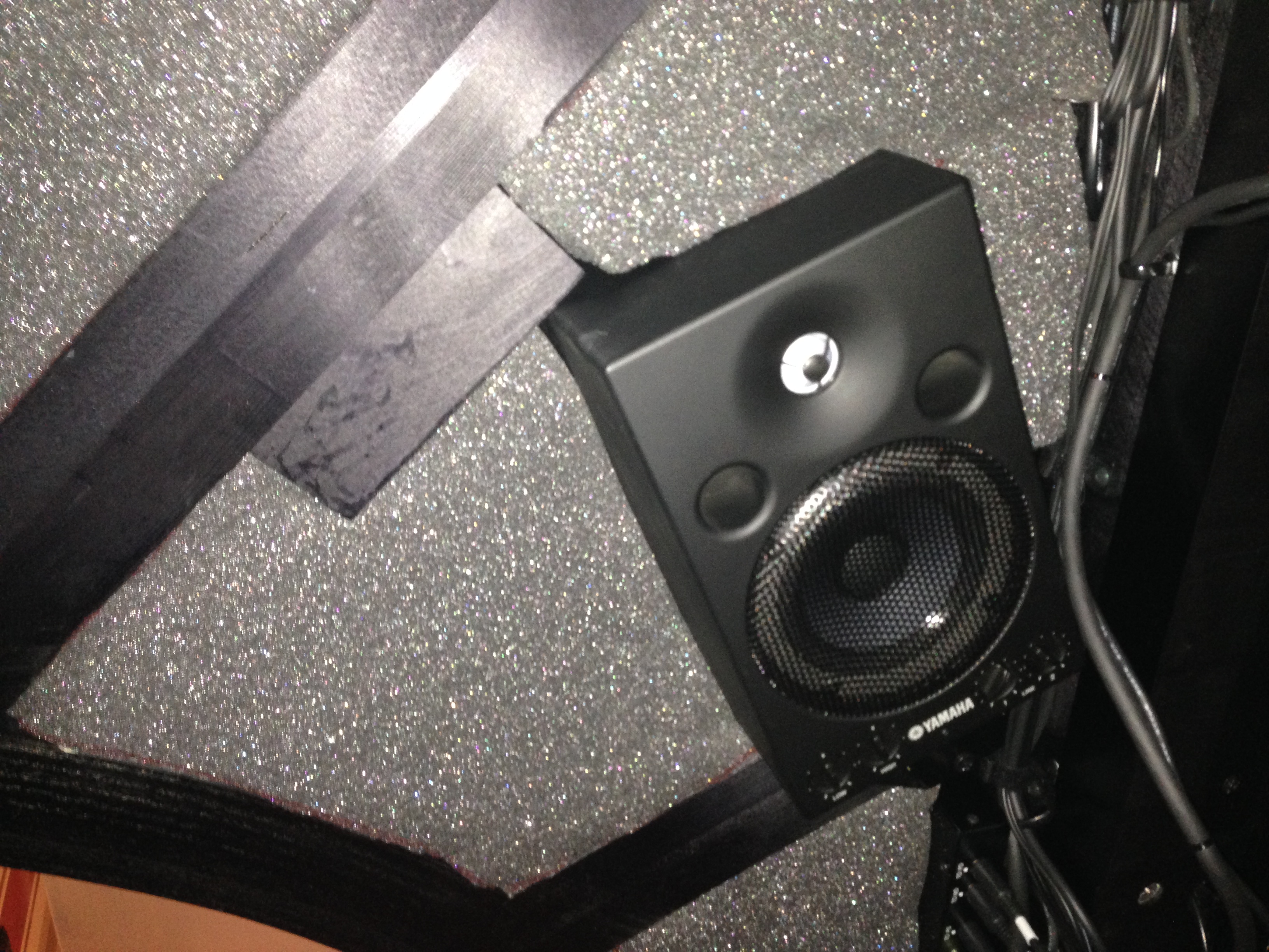

2014-02-09 by Donal Galvin
I bought 6 x acoustic foam tiles which I used 4 and threw out a lot of off cuts. I bought 3 pages of tracing paper which was A2 in size and taped the trace paper to the bottom of the piano and did the trace. I then marked out the foam with a red marker around the trace and cut the foam with the kitchen knife.

Re: [disklavier] Accoustic Dampening [1 Attachment]
2014-02-09 by Joe Morris
Mine looked pretty much identical with the exception that I reattached all if my wires so that I had tight seals against the beams. I noticed that any open areas really let a lot if sound through.
2014-02-09 by Owen Sayers
Thanks for putting up the photos.   I think that you said you used 2" foam.
Is there enough room to use the 4" foam without it touching the soundboard.
I used 4 inch foam and it's not touching the soundboard. I have a C3X so I am not sure if other pianos would have the same measurements underneath
