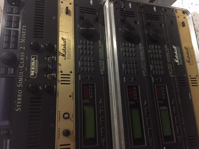

Hi All I have a few 2101's for sale. The one with the V chip is stuck in boot mode but I think it's an easy fix. The top one is in mint condition, the bottom one has some rack rash.
Looking to get $250 each before shipping.
