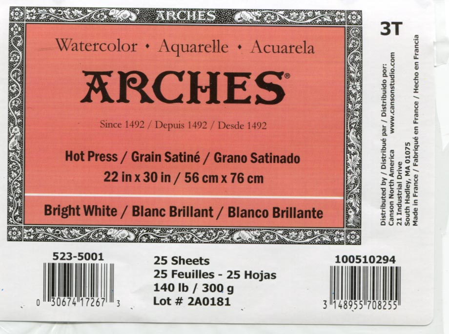

This is the label from the Arches I use:
[image: Inline image 1]
Also on line at http://www.paulroark.com/BW-Info/Arches-label.jpg .

> I guess the paper is called Arches Aquarelle Grain Satiné 300gr/m2 56x76
> cm in Europe. There is often an English and French description on the
> labels, is it correct what I wrote here?
> Met vriendelijke groet, Ernst

Good to get confirmation on the Arches paper label.

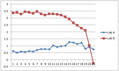

I do not think the OCP creates that drop in Lab b value between paper white and dark grey patch. It is the Eboni itself. Sure it is a clear fluid and the one you use is warmer but I recall that the Vivera MK pulls the Lab b value also to similar levels on warm papers while the Vivera MK is a bit warmer than Eboni MK. On more neutral papers the reading of the dark grey patch will still be on the warm side.
The Eboni ink I have here is old, at least 6 years old but I doubt that has changed either. Maybe it is something in the Non-UV cut Eye One Pro measurement with the Share application compared to your spectrometers that do not measure UV influence on the print + the software you use.
A Vivera MK example on Innova IFA24 Decor Art Lab 97.88 -0.33 2.19 paper white and the dark grey patch selected is Lab 26.12 0.44 0.24, continuing to a black Lab 17.01 0.66 1.41. The last is the result of the Vivera MK only, the dark grey patch has Vivera PK in it which is a near neutral ink. Anyway even with a near neutral paper the grey blacks do not swing into -b values. Measured with the same Non-UV Eye One Pro but MeasureTool of Profilemaker to get the right input for QTR linearisation. No OBA in that paper either. I see similar results with an uncoated, no OBA, offset paper: Biotop Lab b 2.30.
With a paper that has a paper white Lab 98 0.0 2.0 and Eboni + OCP medium mixes the measurements over the tone range should stay close to a b 2.0. I will try that with brushstrokes on the papers mentioned here and dilute the Eboni more for lighter patches.

This is what I have for Eboni Black Only on Arches, printed with the 7800:
On Tue, Dec 30, 2014 at 8:41 AM, Ernst Dinkla ernst.dinkla@... [DigitalBlackandWhiteThePrint] <DigitalBlackandWhiteThePrint@yahoogroups.com> wrote:
While not comparable to a true quad/hexatone diluted HP MK print I measured the HP MK black only calibration strip of my Z3100. Printed on Innova IFA24 Decor Art which is close to neutral on the warm side, no OBA content.
Lab values
1 97.35 -0.24 2.49 paper white
2 90.48 -0.10 2.78
3 83.90 0.07 2.82
4 76.90 0.29 3.09
5 71.55 0.44 3.23
6 65.79 0.62 3.47
7 60.41 0.75 3.67
8 55.34 0.83 3.68
9 50.06 0.93 3.72
10 44.09 1.06 3.89
11 40.62 1.01 3.55
12 33.65 1.16 3.69
13 28.48 1.12 3.27
14 23.61 0.99 2.57
15 18.77 0.86 1.96
16 16.42 0.63 1.34 best MK black
17 16.93 0.46 1.20 too much ink
MeasureTool + the Eye One Pro non-UV cut
So much warmer in the mid range.
